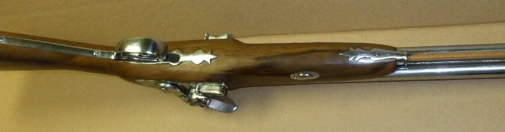

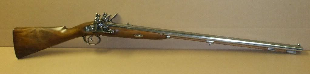

Yup.....After waiting patiently for the past 3 years it is finally happening!
Middlesexvillagetrading will be offering a double flintlock in 62 cal in the new year..
If you check out their site they have a prototype there,
Me, I can only hope they will be available with queen anne style hammers and with the stock rough and unfinished so I can personalize it.
For 700 yankee deneros not too bad!!
My pals 1777 from middlesex is a real solid good gun so I think it bodes well for this new arm!!
A second shot from a flintlock.....its like a dream come true!!
Any thoughts?

Looks as if it could be a good starting point, as long as the locks are of basically sound design and construction. There is nothing like this on the market.
That thing is sooo ugly it would scare game away.

I think this new double after some work could be a jem....engrave the lock plates...refinish the stock, add a musket butplate ,queen anne hammers installed, and dull down the steel just imagine...
Unless it is something about the flint double that turns your crank, I would spend the money on a genuine antique double or single percussion shotgun. I would then have a shooter that fits well and was made slender and light. For the same price I could find an antique shotgun with cast off to the stock and regulated barrels, as well as a piece of history. Then I would never think of purchasing that (edit - THING) again.
Yeah there is the slenderness issue in the lock area....I myself am not completely sold on the arm yet, though I very much like the idea of a double flintlock.
"I love flintlocks " I will wait until the 1st batch are out there and see what the owners say.
I figure after 1or 2 batches whatever bugs are present will be worked out.
Myself....I think its right pretty "except the hammers"

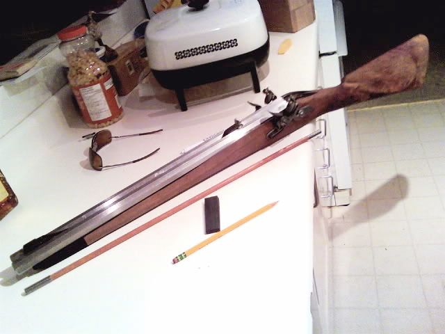

...why not build? You get what you want that way, what I'm getting at is when it comes to things this niche and neat, take matters into your own hands. :)
Won't cost you much if you stick with reasonable materials. Likely, can be done for the price of the Indian but in American black walnut, with American or English locks, quality rifled barrels, and any little touches or look your heart desires...
Here's mine so far in a new pic, not much has changed, about 60% done, locks are now near 100% inletted however. All the fine stuff and finishing is what takes the time... you do that anyway 'polishing up a turd' so to speak. No matter how much work goes in, that Indian double's never going to look right unfortunately in my opinion. Just not a pretty bird from my perspective, awkward thing, but that's just my opinion which means essentially zilch in the grand scheme of things!
And yes indeed... there's something very special about a flintlock double.

Hey John a good question that's easier than it seems, for simplicity just pulling a straight copy from my build thread:
Dead simple, as they're straight octagons. When I'm joining the barrels and the underlug, they will be clamped to a true steel plate, and I'll leave the forward 18" of the barrels free initially incase adjustment does prove needed after test firing. If necessary, it's just a matter of shims in the barrel joint or individual barrel elevation adjustments before fixing the barrels permanently. I highly doubt for the ranges a .45 front stuffer is used at that will be required however, likely will be spot on as it stands, each barrel should print slightly to its side on the targets using the parallel octagons. For sight adjustment, the rear sight is made with a slight build up in the aft base after the dovetail that I'll file (or build to, but the plane looks high) for tuning elevation before fixing to the barrels. The rear sight blade is fully windage adjustable in its dovetail.
As for time, it takes a lot, but less than you might think. I only spend an hour every second night or so at it, it moves along fast enough with nothing more than basic hand tools. In the end, you'll have a much, much higher quality product than the Indian as well, with enough attention to detail no reason it can't be the equal of true $5000 customs. Most of the price for them is for the hours spent at it, not the materials.
