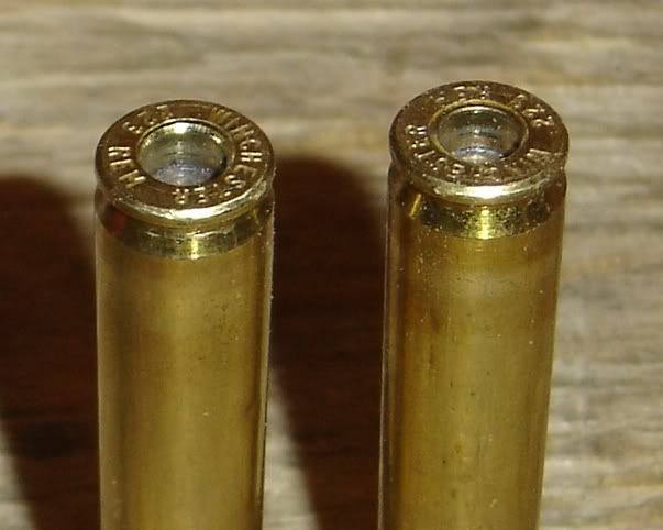

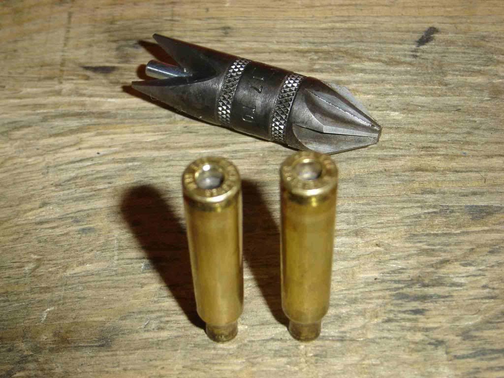

I have a L E Wilson case de-burring tool. I reamed out one case by hand with just a few turns. I compared two cases, one reamed and one not by pressing in new primers. The reamed one was definately smoother BUT no easier than a factory uncrimped case. (So theres no worries about the primer "falling out" so to speak.
Thoughts?
Reamed on Left....Unreamed on Right
