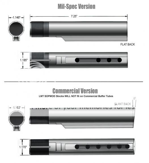

I know my buffer tube is 1.148'', just measured. From what i have searched i come up with milspec tube.
As for stock, i have not found measurment anywhere. I just measure the inside of stock and came up to 1.180''

You can tell from the pic posted... a commercial tube is 1.168" and a milspec 1.148". You measured your stock at 1.180" and your tube at 1.148".
You have a commercial stock on a milspec tube. A milspec stock will tighten it up considerably, but some are better than others.
Edit: Well, unless you measured wrong.

This!!! I just measured my "Guaranteed" Milspec stock. I got two measurements depending on where I put the gauge. If I measure the inside of the stock at the very outer lip I get 1.150" if I slide the gauge in ever so slightly I can get your measurement of 1.180" could be slight tolerance differences in the molding process.
Any of the collapsible stocks will have some rattle to them, I would suggest since you are 100% confident your buffer tube is Milspec, upgrade your stock to a Milspec Magpul CTR with the secondary locking feature and the rattle will be gone
Should be measuring the tightest spot, naturally. But yeah, a crummy stock will rattle regardless... as the man said, a Magpul CRT would be best.
