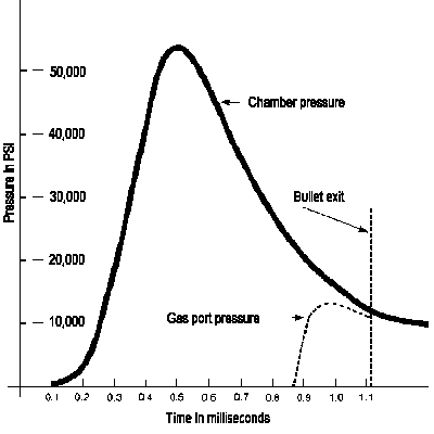

After the peak, even though no additional pressure is being added because the powder is no longer "burning" (in fact the pressure is dropping), the pressure is still high enough to accelerate the bullet and could (depending on various factors) continue to accelerate the bullet for 30, 40, even 50+ inches, if the barrel was that long. Once the force from the high pressure gas is overcome by the friction of the bullet in the bore, the bullet will stop accelerating.
