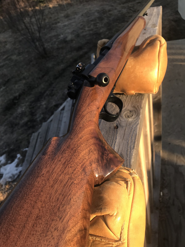

Iv been using tung by itself with good results. Sometimes I’ll add 10-25% spar varnish on my last coat (25% in the photo), adds a nice finish but does mark up easier.
