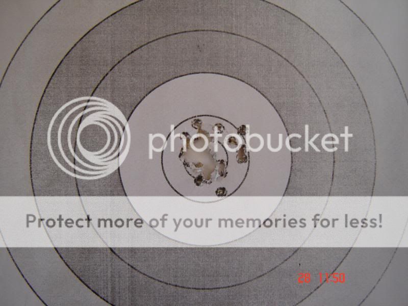

This target ,20 shots at 100m, was shot in a 15-20 km/h switching wind with heavy mirage as the morning air warmed. The hold was between 4 o/c on the 9ring ,3rd line from centre, and 9-10 o/c on the 9ring.
Good luck with your trials

Changing atmospheric density caused by varying temperature which bends the light rays coming off the target results in mirage. Probably one of the best ways to learn how to hold and shoot in it is to do just that - shoot in the condition ,make notes of what is seen and the resulting impact. Mirage can hurt you or it can help you. In windy conditions ,mirage is an excellent indicator of switches or changes in direction and strength. Holding into the mirage is the general rule.Adjusting the sights can be done relative to how constant the condition and/or confidence of the shooter.
That is some awesome wind reading.
Just started practising with a rimfire and working on ammo to use. What ammo were you using? What rifle?
Leeper, great explanation. I try and make mirage my friend but it is a fickle friend. But I know the feeling when you can 'see' it dance, it sure feels good.
Jerry
That session was one of those "Holy Grail" moments. Shot with an early '60s vintage Rem 40X with a 36x Leupold and Lapua Pistol Trainer ammo. It is true what Bill Leeper said about the sensation being almost Zen-like. The target is courtesy of kombayotch - his target for his F-class smallbore matches.
