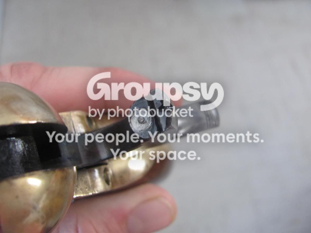

I just got this Pietta 1851 Colt replica. I test fired it yesterday after replacing the hand and the wedge. I had 4 misfires on the first cylinder but they fired on the second try. I'm a total newb so maybe the caps weren't far enough on the nipples. I'll pay more attention to that next time. The main spring seems strong. But I'm wondering if the hammer face could be part of the problem. Is this normal or a sign of excessive dry firing or just lots of use? Should it be flat? Should I remove that little nipple in the center?

Can you take a picture of the rear of the cylinder to show the condition of the nipples, I had a similar problem with mashed nipples from dry firing that lead to mis-fires.
Don't start removing metal from the hammer until the problem has been diagnosed properly.
The nipples are as new. Not mis-shaped at all.
I know, I don't want to touch anything until I'm reasonably sure of what the problem is. Could it be that I didn't slide the caps on far enough and the first hammer strike drove them down on the nipples but not firing them? How hard should you force the caps on? I was pretty gently with them fearing accidental discharge.

Take the cylinder off (with no powder) and try fitting the caps, if they are too tight to go all the way on with reasonable pressure they may need to be trimmed. Before you do that though put the cylinder back on and check the fit between the hammer and the nipple with the hammer all the way forward, put a bit of rearward pressure on the cylinder then push forward on the hammer to see if they are touching. A picture of the rear of the cylinder would help figure out what that dimple on the hammer face is for.

A CGN'er has confirmed that the hammer face is as it should be. So I've got to make sure the caps are seated all the way. In lieu of that, my other options are try new caps or verify that the main spring is strong enough.
