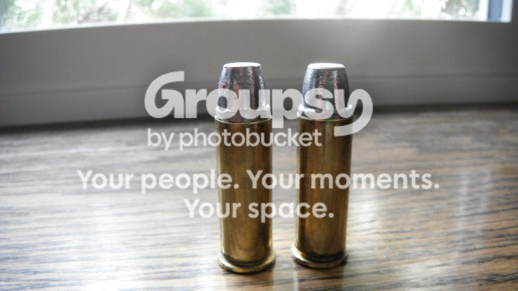

The one on the right is seated a little bit too deep. The one on the left is not seated quite deep enough.
To make life easier for yourself, for the first time you set your seating die, start out by leaving the die with enough space between it and press, that it precludes any chance of crimping the case.
Now, adjust the centre screw only, for getting correct seating depth. As the bullet gets near correct position, use very tiny adjustments, until when you bottom the die handle, the bullet is correctly seated. Correct seating is just a hair more than your cartridge on the left.
