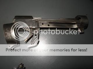

An old rifle I had basically given to me by a friend. At one time, it was a .22, then redone into a .303. I've kind of forgotten the story, but the butt stock went to one CGNer, and the receiver and bbl went to another. So, the poor old thing ended up being a donor to help restore some other rifles.
I just thought it was a neat wrist socket stamping.

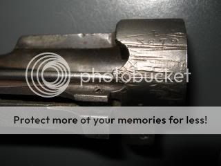

I was the lucky recipient of the barreled action. I was interested mainly in the barrel, which was of carbine form.

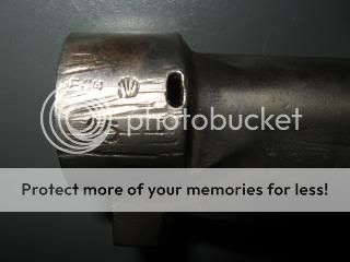

The barrel and receiver had been tackled by Bubba who had attempted to remove the barrel. The underside of the barrel had a second honking big flat ground into the barrel reinforce, no doubt so it could be held in a bench vice more securely. Bubba was unable to unscrew it and appears to have given up before he chomped into the metal too much with the pipe wrench. The receiver ring has a few cuts and gouges, which is a real pity as the ring is C broad arrow marked. The barrel too was a crying shame. A LMC carbine barrel circa 1894-96, that had been bushed for use on an RIC conversion.
I spun the barrel off in two seconds using the correct barrel vise and receiver wrench.
I had a 1900 carbine receiver in the parts bin that was heavily pitted below the wood line. I looked in the bins and found a bolt body, a mag and trigger guard, and, and....
The assembled action went into a sportered carbine woodset that had been sanded to death. I checked the headspace and thought 'why not?'
I had some gallery loads to test out so she was barking in the bush again. The barrel bore is less than poor. Originally Metford rifled, there is not much left that looks like rifling. The thing keyholes at thirty feet.
However............
I just discovered some .22 barrel liners that are 5/16 outside diameter and will slip into the 303 old bore. So yet another project. A Royal Irish Constabulary carbine clone chambered in .22 rimfire. As if I needed another project.............
The Sht.22 Mk.IV* receiver, sits waiting for inspiration. The charger bridge has been removed. The receiver ring is chewed. But the body is not sprung or twisted.
If if anybody can make use, they are welcome to it.

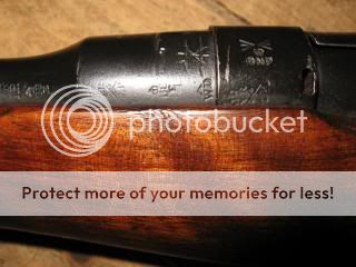

Hey! Now that is interesting. When I took that poor old rifle into my fold, I was fascinated by the story on the wrist socket. The old thing isn't going to go down without a scrap. The wood found a home, and now the rest will likely live on in some form. Good work boys! Good work. :)

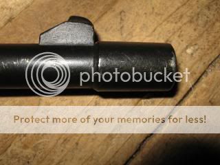

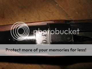

I built this RIC carbine starting with just the RIC barrel in the story above.
The bore of the DP marked barrel cleaned up but is still heavily pitted, but plans are afoot to fit a barrel liner and convert it to .22 rim fire.

Just to wrap up this story. The receiver found a use with a bunch of orphan parts out of the junk drawer. Almost seems like a free gun.
I took it out plinking this afternoon. A pleasure to shoot. This is now my official squirrel gun and will reside in my garage.
