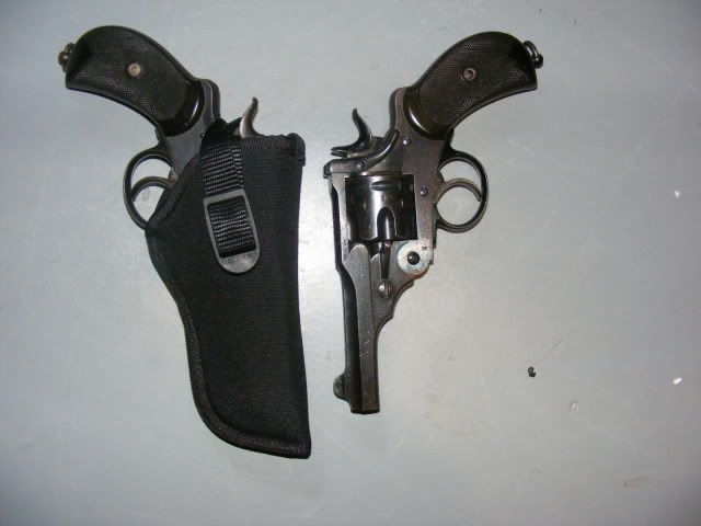

Uncle Mike's Size 2 is a nice snug fit for 4" MKI/II webleys.

Here's some pics of the MkI and a size 2 Uncle Mike's holster. US$15 for this one at Walmart in Anchorage, AK. :) Carries nice, snug fit no movement inside holster. Point of contact is the topstrap and the trigger guard, not the tip of the barrel, which is perfect.

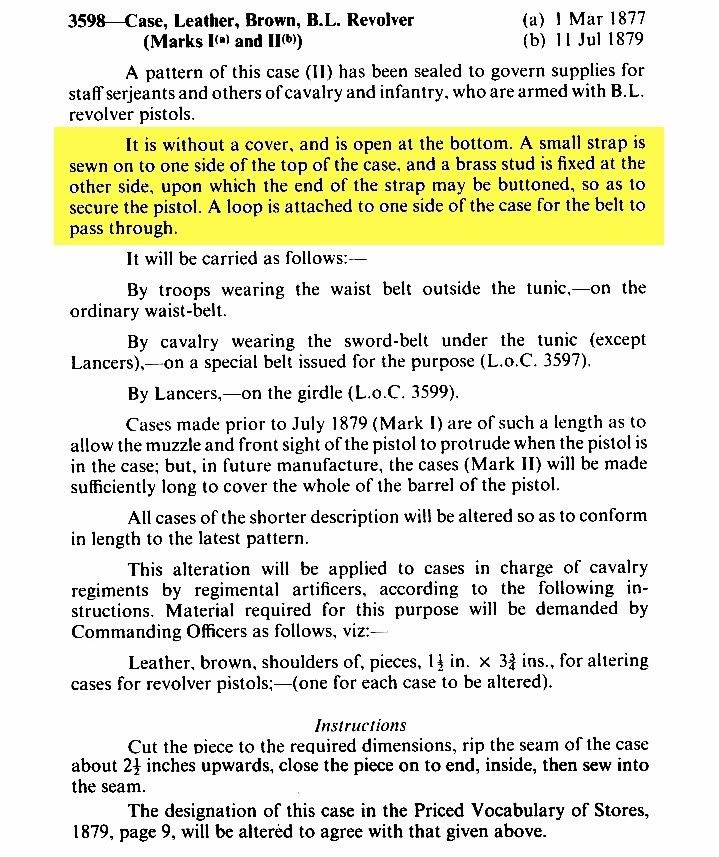

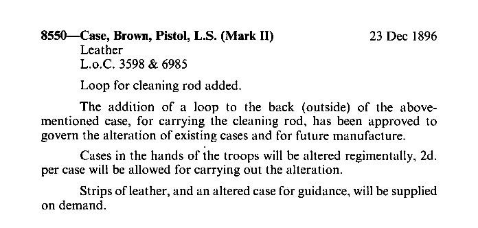

If your revolver has WD markings, then the correct revolver case (War Department term for holster) for it would actually be the open top version first introduced by the War Department in 1877 (a decade prior to adoption of the Mark I Webley revolver) for issue to any Other Ranks deemed to require a revolver .... It should look pretty much like this one - a Mark II, with the loop on the back introduced in December 1896 (and which was to be added to existing cases, as well as incorporated in all subsequent manufacture .....)

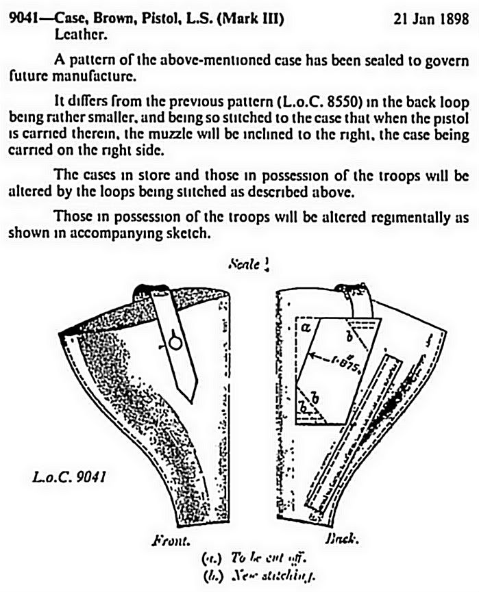

And now, for those prone to say "show me" or those who appreciate "primary source" documentation, here are some relevant entries in the British War Department's "List of Changes" (only the last of these was "illustrated", but I have highlighted the description in the first one) -
