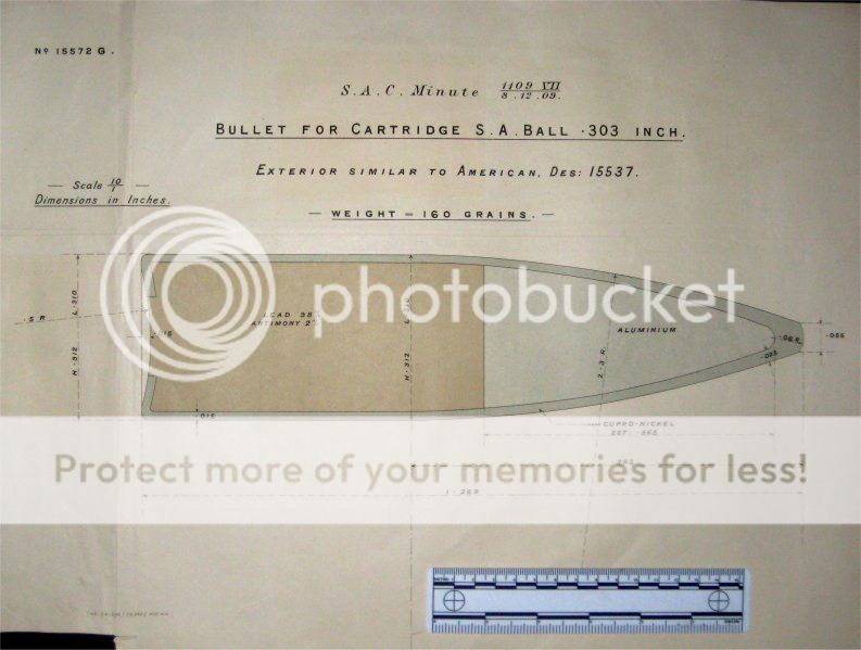

Hey guys I'm looking for .303 Brit MkVI specs. COAL, bullet diameter and weight, type, etc. Also if anyone knows the original spec for rim thickness that would help a ton too. Thanks!

An excellent soliloquy by Smellie on the subject in this somewhat confused and derailed thread. http://www.canadiangunnutz.com/forum/showthread.php?943800-303-ballistics-a-question-for-the-expertsDon't mean to derail things, but what mark of cartridge would be used for an 1896 LEC with enfield rifling? I'm trying to keep the pressures down since there is a spot under the barrel with a fair amount of pitting.
