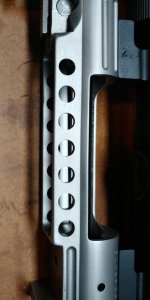

If I get a light weight stock and turn the barrel to a thin profile what is the chances ill get this under 6 pounds? Maybe skeletonized the bolt handle or action a bit?

Yeah you'll need to concentrate your weight loss on the barrel and stock. I bet the wildcat stock will get you the biggest weight loss of all modifications. Skeletonizing the action makes it look cool, but you don't lose a lot of weight. Mine weighs 6 pounds 10 ounces (in 7mm rem mag)

With a recontoured barrel, glass stock, and FWT bottom metal, you can probably manage 7 to 7 1/4 pounds, all up, unless you insist on a heavy scope and mounts.
