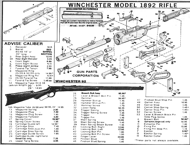

What is your opinion on fore stock bedding on a model 92? I've been having some vertical stringing issues with mine and I'm trying to reduce that a bit.
My rifle is a Rossi model 92 with an octagonal 24" barrel, so there aren't any barrel bands the mess with. However, the front of the mag tube sits inside a guide and is pinned tight, and the front of the stock is hung from a tenon, both of which are dovetailed into the bottom of the barrel. That's a fair amount of stuff hanging off the barrel.
Not the greatest image, but functional:
What would be the best way to reduce the influence of the magazine / fore stock on the barrel? Would bedding the fore stock barrel channel make improvements? Any other tips?
Thanks for the help.
So far I'm getting something like 5" vertical and 1" horizontal at 50m, which is nowhere near reasonable. I want to use this rife for lever gun silhouette matches, so sub 4" performance is what I'm looking for, which isn't asking much I don't think.
I plan on starting fresh and shoot the thing with no magazine or fore end, then I can add parts until the groups start opening up again. There's a chance it could be magazine spring tension or the way I'm placing it on the sandbags is throwing things out.
