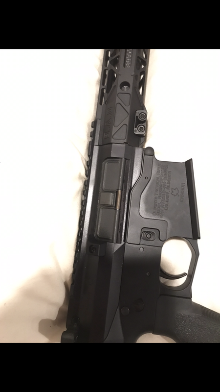

Mine has a bit of overlap as well:
I'm having a similar issue to this, but on mine, If I pull forward on the upper, then mags drop free.
I've only tested this with LAR mags.
this actually has to do with the square corners of select magazines, and the radius'd corners of the upper. The worse offenders I've encountered, actually have a dent on the magazine where the sheet metal is folded (orange follower, 10 round pistol mags), that protrudes forward from the rest of the magazine. On some receiver sets, with some mags, it's caused them to not drop free.
IF your set is having this problem, you are welcome to email us at info@albertatacticalrifle.com and we can give you the information to ship it back to us, and we can machine a little more clearance in there. This isn't something to be done to everybody's, but if your having issues don't suffer in silence, get a hold of us. It could be something really simple that's binding it up.
