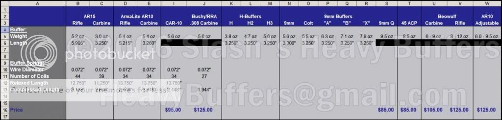

The buffer I have is a "308" buffer, but as far as I can tell, that doesn't matter, it is the length and weight that are important. It is at home currently so I'm not 100% sure on the length, but it weighs 3.2oz. According to heavybuffers.com, the AR-15 carbine buffer weights 3.0oz. and is 3.25" long, the same length as the AR-10 carbine buffer. Seems to me, I could use the buffer I have, as increased weight serves only to slow the fire rate, if I interpret all this mumbo-jumbo correctly. BUT, a lot of the information I found recommended an 'H' buffer (3.8oz/3.25") for a 16" midlength upper. I confess I have no idea why the length of the gas system would affect the buffer at all, except to possibly decrease the time between firing and the action cycling???

If you find yourself in need of a buffer, go back to heavy buffers dot com, order their 6.5oz, and a WolffXp spring for good measure, and call it a day.
I bought their Adjustable kit and played around a lot, settled on the max weight of 6.5oz, and use it across the board on all my uppers.
