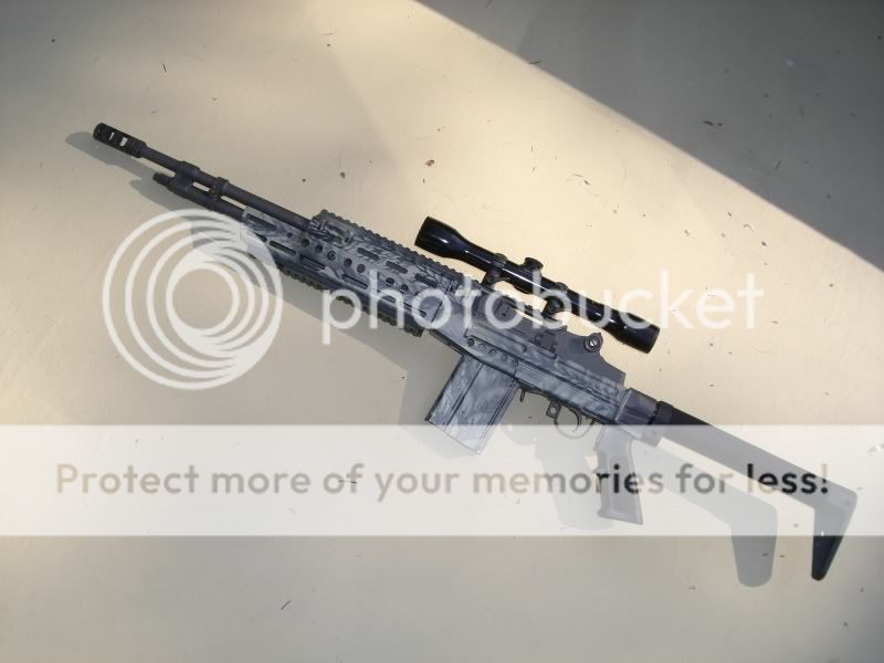

Laz2000 asked me to post these up for him. He took the butcher knife to one of the AKM stocks and it turned out pretty decent.
Apparently the rifle weighs 11lbs as you see it.
Does this ease the pain:)
The biggest problem with AR pistol grips on stocks like this is that they lack the full web support that one would find on a AR, the pistol grip lacks full web support. I find them uncomfortable in the hand. Plus the length of the grip make spacing difficult.
I think these stocks are ugly because of the lightening cuts they put into the aluminium. Circls, and oblong circles randomly mashed in there.
Nope. Grip is still too far away. I'm looking at it from a guy with paws standpoint. my fingers are short but my palms are massive. Hence the term PAWS.
I remember you have paws alright, but you have to handle it to beleive it, that's not a big distance between the trigger and the grip.
If you have the AR grip installed tight onto the trigger guard it'll be waaaay, waaaay too close. You'd be firing using the proximal phalange, not something that is much desirable
So that retarded gap makes for proper ergonomics, eh? I've always been a function over form guy as it is, but the gap always made things look like it was too far away.
The 'retarded gap' is there to ensure clearance for the removal of the trigger group as well.
The grip can sit flush with the edge of the trigger group and still allow the removal of said trigger group. When we did the mockups for our chassis we decided to go with AK type grips over AR grips because you get the proper hand placement and and full web support, both of which are lacking with AR grips in this type of application.
Very interesting. Would a Vz58 grip work in the same fashion?

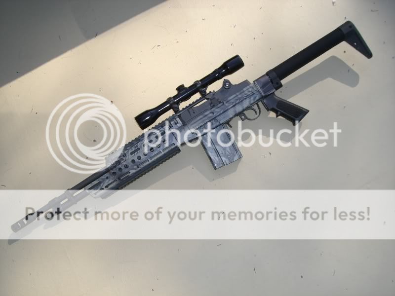

I am maybe/possibly/perhaps considering selling or trading off my camo painted AKM chop mod stock, as pictured above.
Anyone interested?
Cash is not really a priority right now, but maybe an interresting trade??
The stock would be available with or without the YHM tube butt stock and AR 15 full length buffer tube that hides inside the YHM butt. I know most people prefer a sliding stock on their AKM, but the chop mod balances better for me with the YHM tube stock.
The chopmod with YHM butt weighs in at 5 Kilos with a shorty M14, with comp, scope and an empty 5/30 mag, and it balances WAY better than the regular AKM stock. I tried two different Norcs in it last weekend, using iron sights and a 4X scope, and shot off about 40 rds ...
as 5 rd strings, mostly to see what ammo it preferred.
With one norc, basically a stock shorty, it was totally reliable, but it shot about 2" -3" groups.
With the other norc, highly modified with GI bolt, round op rod spring guide, etc, it shot one group that was sub-moa [ Federal 150 gr hi shock SP ], but there were a few stoppages as the extracted brass got caught between the rail and the receiver.
This is a warning to those using the GI bolts and GI extractor/ejector and spring ... sometimes you have to clip a few coils off of the ejector spring to get the extraction just right with a low mounted scope rail. This also occurs sometimes with the new style solid bridge ARMS mount.
So the AKM rail will probably have a meeting with Mr Milling machine, to groove out the right side to clear.
Any one else have issues with their AKM rail biting the brass on the way out?
