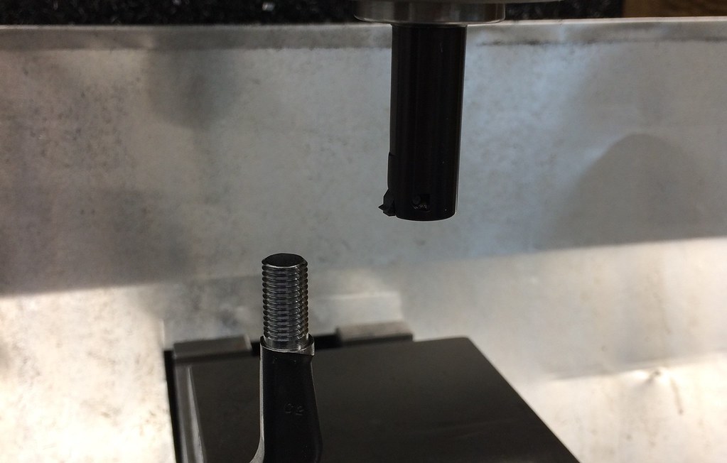

The operation can be done on a lathe with the bolt body held in a jig, or on a vertical mill, using an appropriate annular cutter. One advantage of these methods is that it is easy to leave a shoulder for the knob to butt up against.

Hey Mark, If you're interested, I do bolt handle threading as well as make custom knobs.
More info/options can be seen on my web site:https://www.prprecisionrifles.com/products-1/p/custom-bolt-knobs
Feel free to PM me or send me an email if you're like to discuss!
