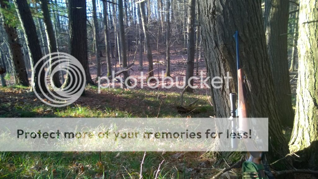

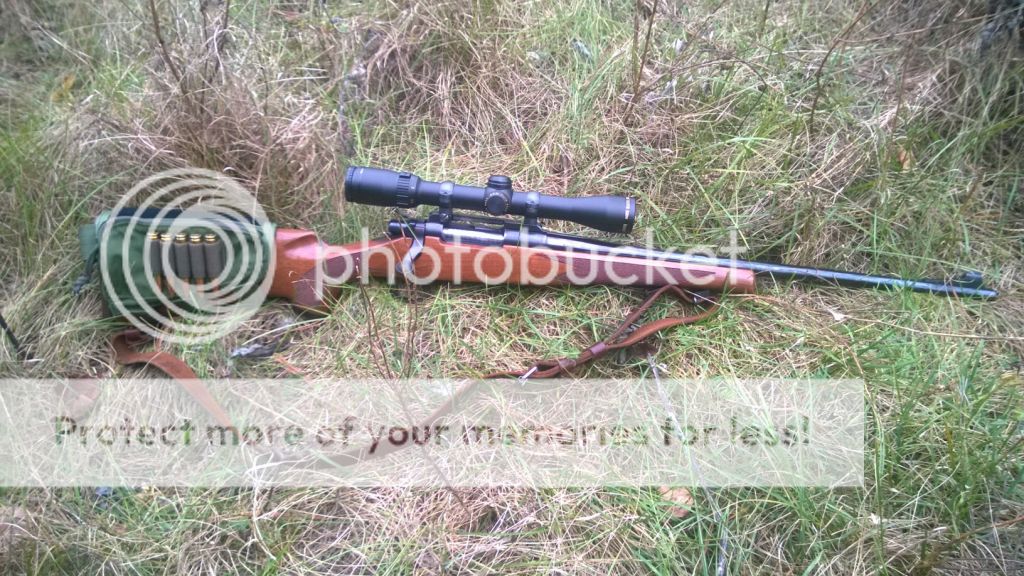

I have a Model 7 in 358 Winchester that I hunted with this fall. It is reasonably light compared to many other rilfes I've used in the past, but I do a fair bit of walking and would be interested in making it a bit lighter. It currently is in the factory wooden stock, and as it has a 3 hole receiver has a one piece Redfield scope base, STD style steel rings, and a Bushnell Elite 3200 1.5-5x32 scope.
A couple of changes I was looking at to lighten it some more, was replacing the wooden stock with a composite stock, and likely changing up the scope base/rings to a 2 piece Talley lightweight set up - which would mean having to drill and tap a 4th hole in the rear bridge.
I'd be interested in stock recommendations and other options to lighten it....??
