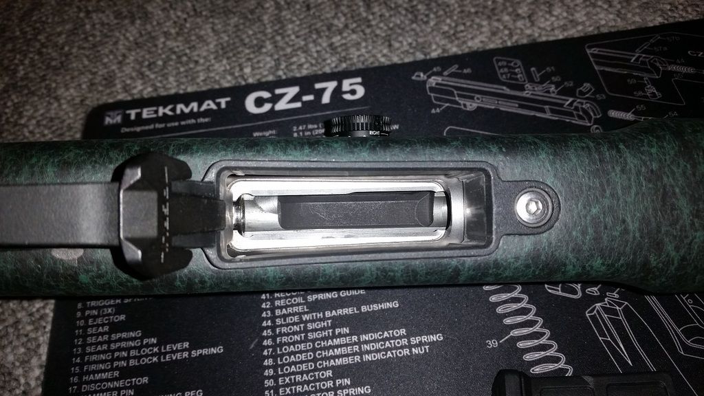

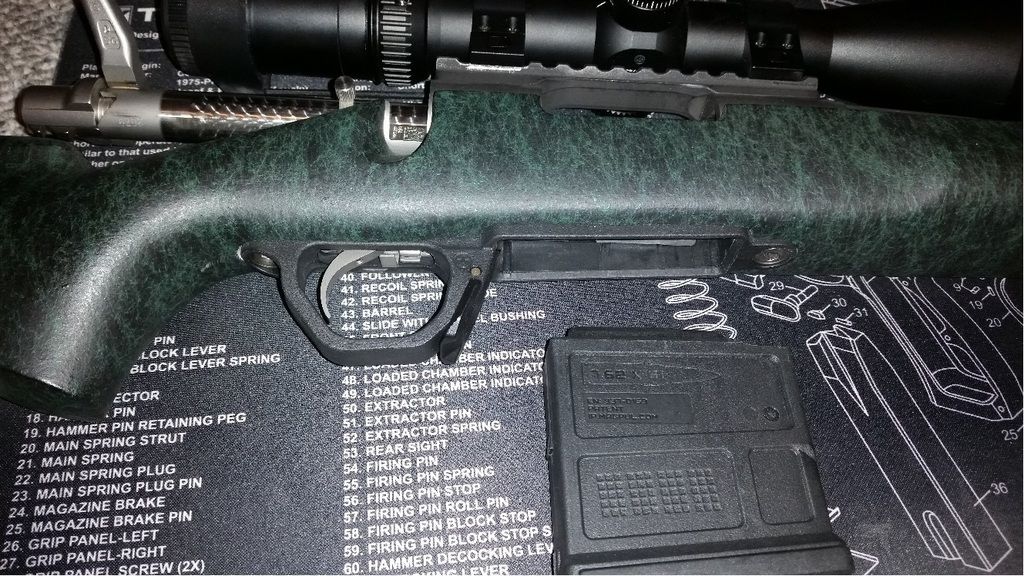

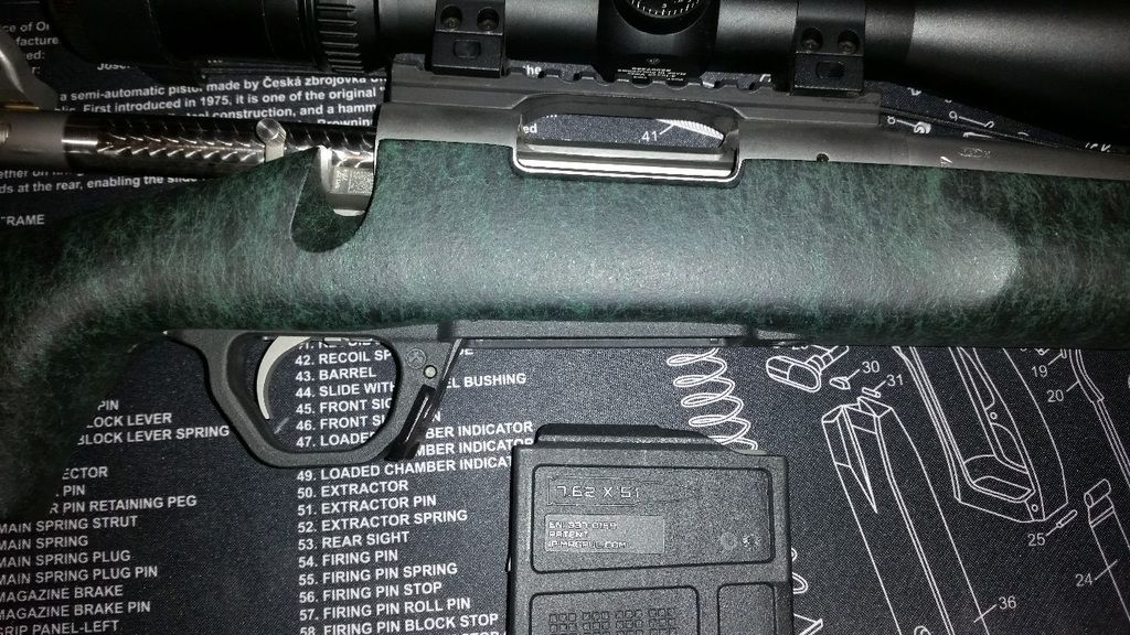

Easy 9mm - Would you mind posting pictures of yours? As our stocks are very similar, it would probably be the same process and end result.
Mine looks about the same as Barney's (maybe a little cleaner). You can see that it protrudes a little below the stock. Functions perfectly with the Mapul mag (and it fits my MTD and Accurate Mag from my 223 for those considering it for 223)
Would I do it again? I'm not sure. Like most Magpul products, great price and great quality as far as polymer goes, but I think something stronger would be better suited with the HS stock. Look at what PTG has to offer, I think it would be better suited to the HS stock.
Anyway, here are some pictures.
