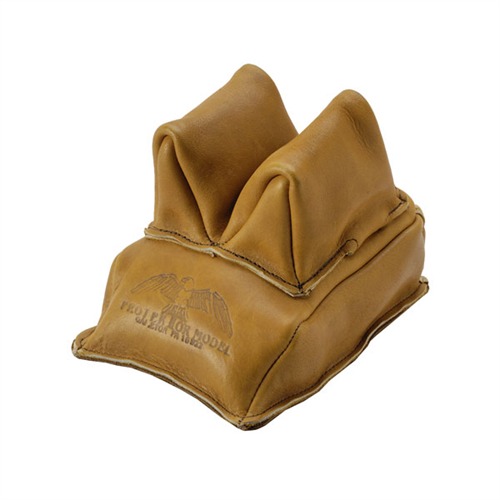

A rear bag will be much more effective then a mono-pod for shooting. More effective for managing recoil and more effective for managing small elevation changes.

Instead, get a rear bag that properly conforms to your butt stock, that allows the rifle to track straight back, provide stability while also allowing for vertical adjustment via squeezing the bag.
As mentioned, a rear bag is the way to go. Also, I've found using my balled left fist under the butt stock really helps and is almost as good if a rear bag is not available. Just by squeezing your fist more or less you can fine adjust your elevation, just like with a rear bag.
