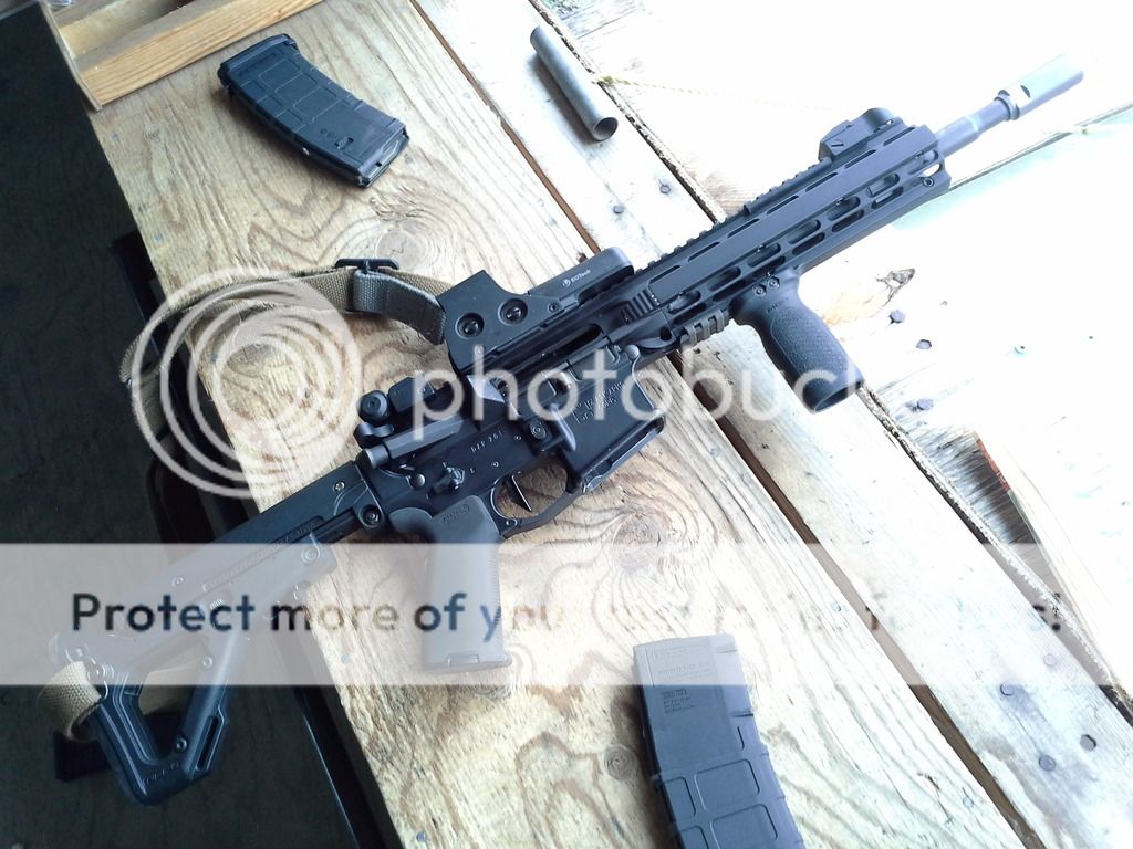

Chiming in again since I'm at the comp now and can better type.
I have an Aero COP, I haven't had any other monos to compare it to, but so far it's win win.
It's modular, so you can set it up with any rail config you want. It can be a quad, or a slick side tube. You can also have half rails, so you can set it up like the IUR or maybe have slick sides and half of bottom for a vert grip, which is realistically all most people actually put on their rails that they need.
It's weight is good. The balance is also good.
My calculations put it in the same range at a normal upper, with a typical rail on it. Example, the weight of a carbine length COP is identical to the weight of a normal upper with a LaRue carbine rail fitted.
Once put together it's solid.
I handled an IUR before, the ergos and weight were jacked. Front heavy the the rails are right where I don't want them to be.
My COP build is a streamlined smoooth operator.
