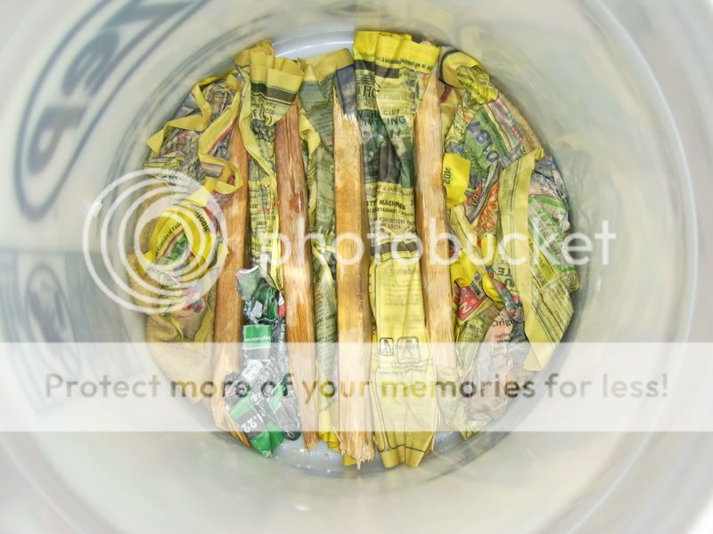

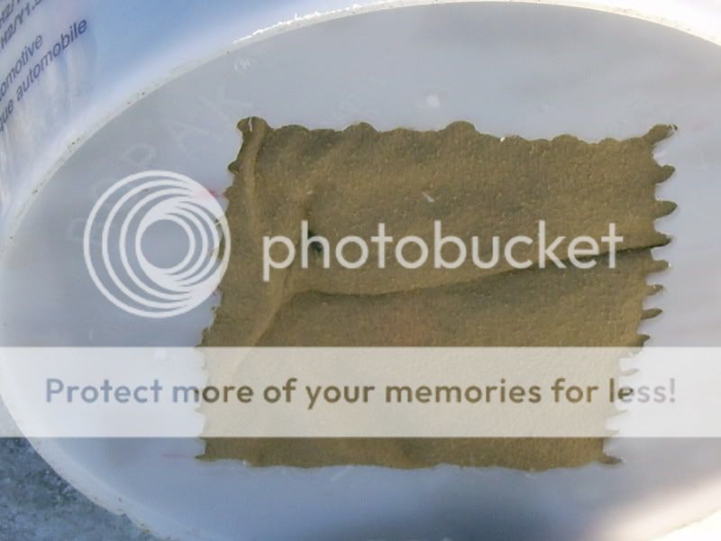

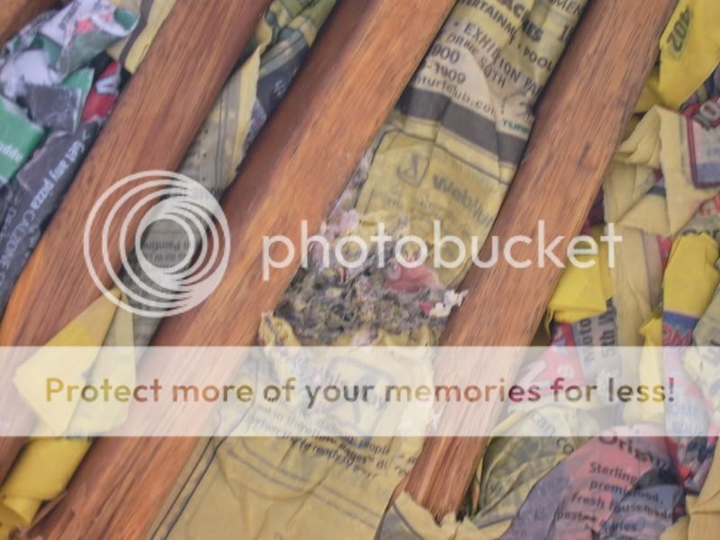

Then I cut appox a 6x8 inch hole in the bottom of a 5 gallon pail. Inside the pail, I placed a soaked and wrung out Chamois cloth. This is as close to skin as I could think of. On top of the Chamois, I placed 4 hardwood strips, and packed soaked paper between each one. I know it's not perfect, but I figure these should represent ribs alright.

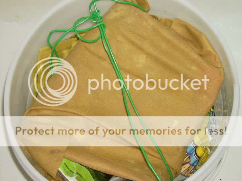

I then packed several books into the bucket and the last in is also wrapped in a Chamois. If the bullet manages to make it through, the Chamois is there to act as skin and show (hopefully) the exit like a hide will.

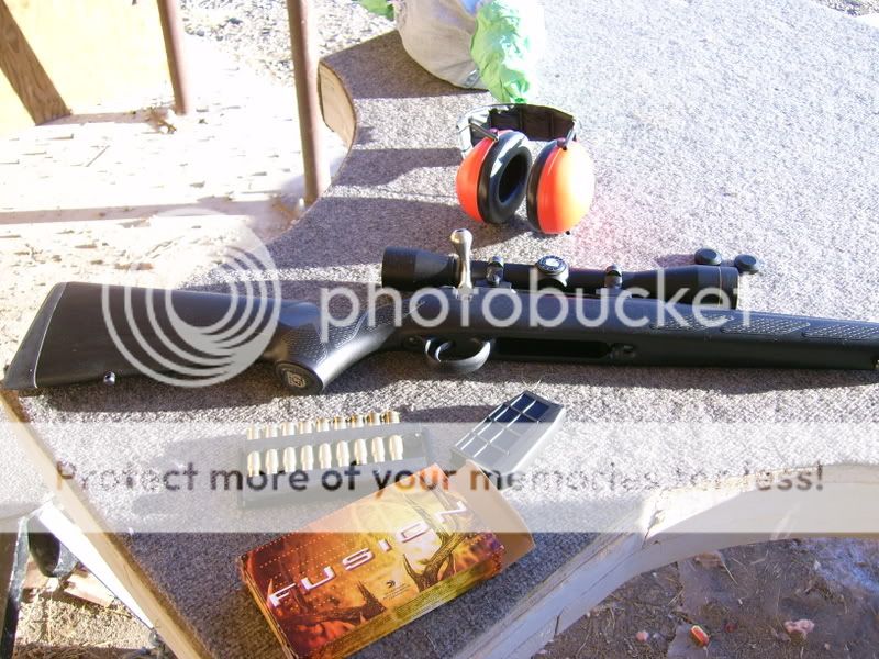

I started by sighting in the Tikka at 100 yards. It took me awhile, as I kept buggering up. Eventually it printed where I wanted it. The factory loaded 200 grain Federal Fusion bullets didn't shoot as well as I hoped, but good enough for my test.

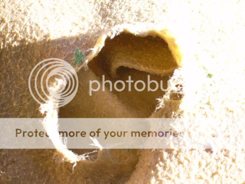

The bullet entered a bit high and left.

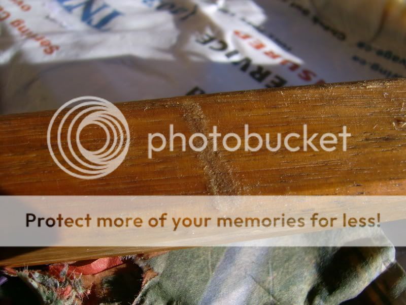

Upon entering, it literally grazed the wooden "rib" as it passed through the chamois skin.
Here you can see the mark where the bullet passed by. As in a real life hunting scenereo, hitting a rib or passing between is a luck of the draw thing. It was no different here, though I confess I had hoped the bullet would have struck one.

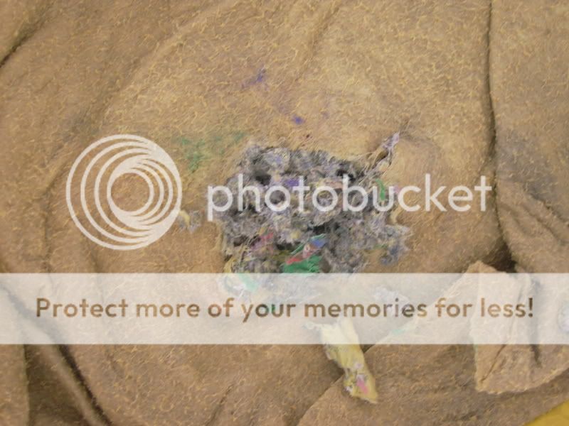

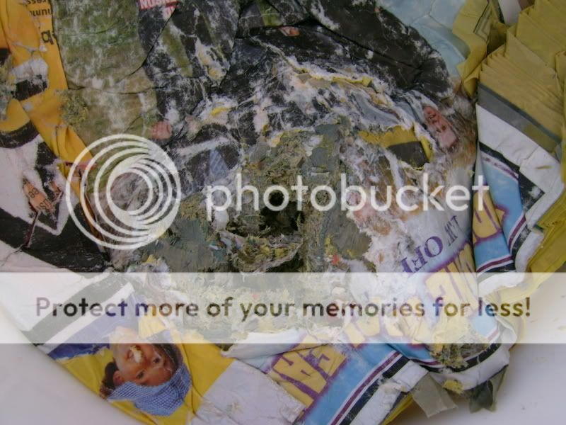

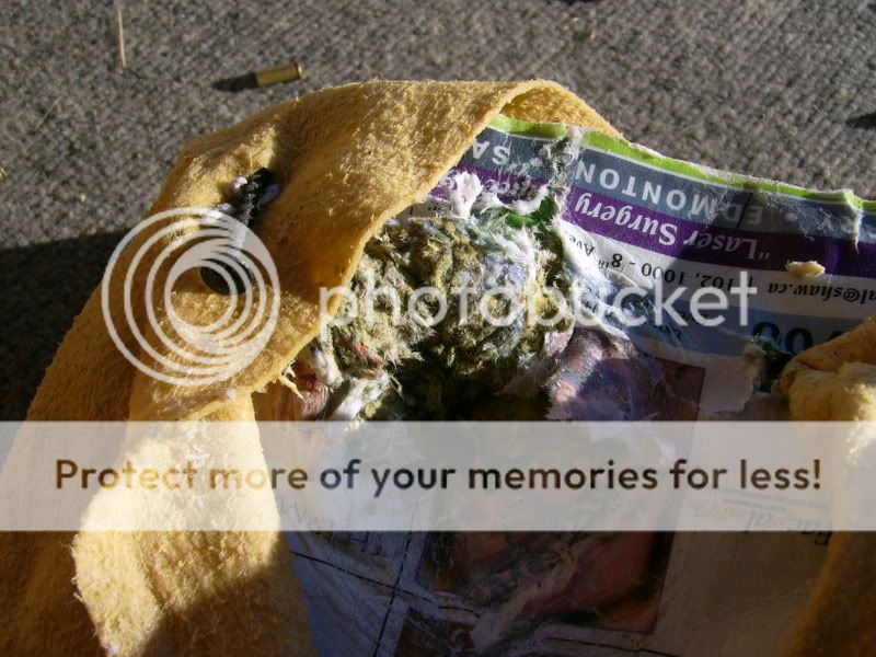

And here are some shots of the carnage. I'll skip posting them all, but you can see the wound channel near the start, halfway through and then at the end.
Half way in, I put another layer of chamois to act as the diaphram if you will.
I recovered the bullet 2 inches to the right of the bucket. I am confident that the bullet expelled it's energy in the bucket, and the chamois at the end acted the same as skin would have. I screwed the chamois to the last phonebook from the backside to hold it tight upon impact. I'm certain if you slowed the video down, you would see the chamois stretching the same as skin would as it is pulled from the flesh.
