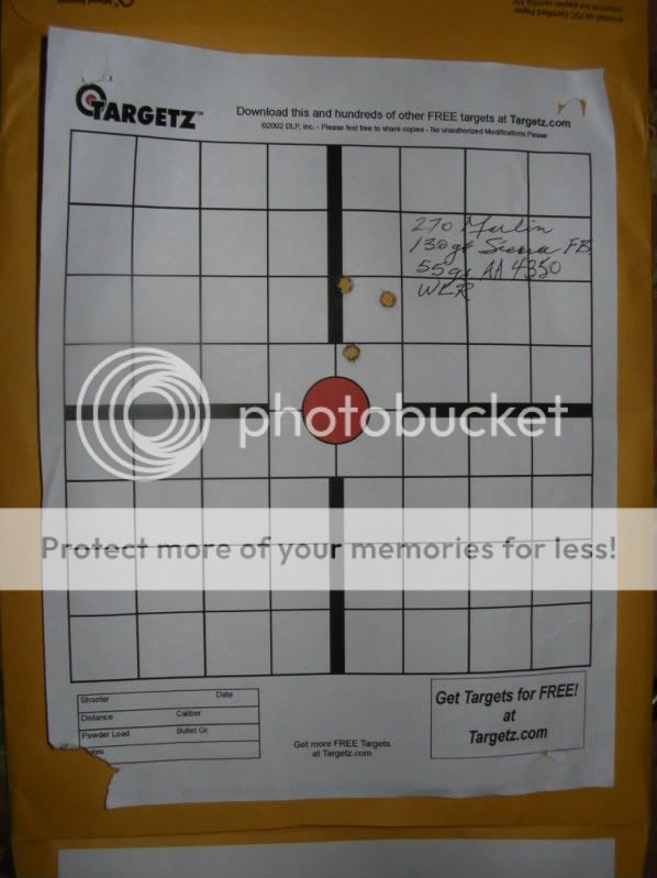

I bought a Marlis XS-7, 243 Winchester, from a fellow gunnut a while ago.
I threw together some ammo with 100 grain bullets [4 types] and a couple of
different powder charges.
It would put two pretty close, and then would drop one about 2" to the right.
If I shot a 4th round, it was usually even further to the right.
Seemed to do this no matter which load I tried.
Took it home, pulled it out of the stock, took a close look, and removed the two "pads" at the front of the barrel channel completely.
Adjusted the trigger to an even 3#, Screwed it back into the Fiberglas, and headed
to the range again.
Last 4 groups I shot were all 1" or smaller, without flyers. [Hornady 100SPFB IL shot best @ .67"]
We have some 3" gongs at 200M at the range....was able to hit them regularly without any issues.
