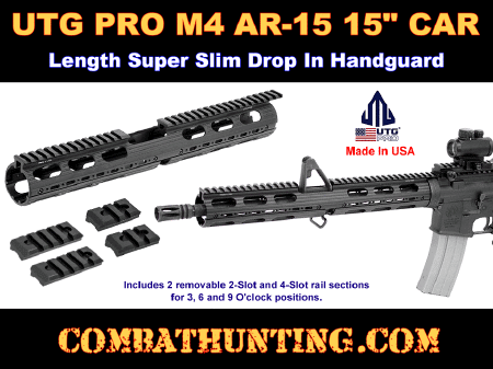

Alternatively you can buy a Vism or UTG Pro Carbine Length Extended Handguard which works around your A2 front post if you've got one I can't remember if the oracle does or not... that way you don't have to change the gas block or free float your hand guard. It's drop in no tools required.
You won't have the added accuracy in your irons that a free float will afford you but you'll likely be using your upper rail mounted RDS and magnifier anyway (irons as back ups)
Only problem is, I can't find anywhere in Canada with the UTG Pro version in stock.

VISM and UTG is garbage and about as bottom of the barrel you can get.

Vism yes (it's NCStar) but UTG Pro is made in the USA and is getting quite good reviews online.
UTG and UTG Pro (Leapers) are totally different product lines... yes UTG started out as Airsoft parts... so did magpul ;)
Leapers is absolute garbage as well. Just because its made in the US doesnt mean its any better.

Or maybe their drop in non free floated handguards are really all someone who buys a budget AR to shoot a handful of times a year really needs.
Judging by your HK avatar I'm thinking affordable options aren't really your bag.
