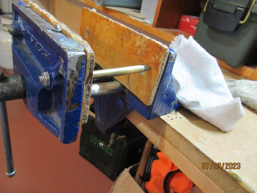

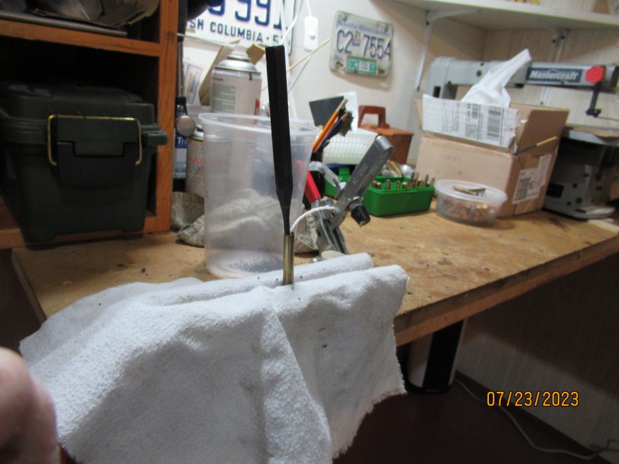

I only reload 1 Black Powder Cartridge 22-15-60 , it calls for 15g of powder .
Different measures I have used are 8g , 10g as well as 15g the space filler used
is white string (any kind) seems to work fine.
...skwerl
