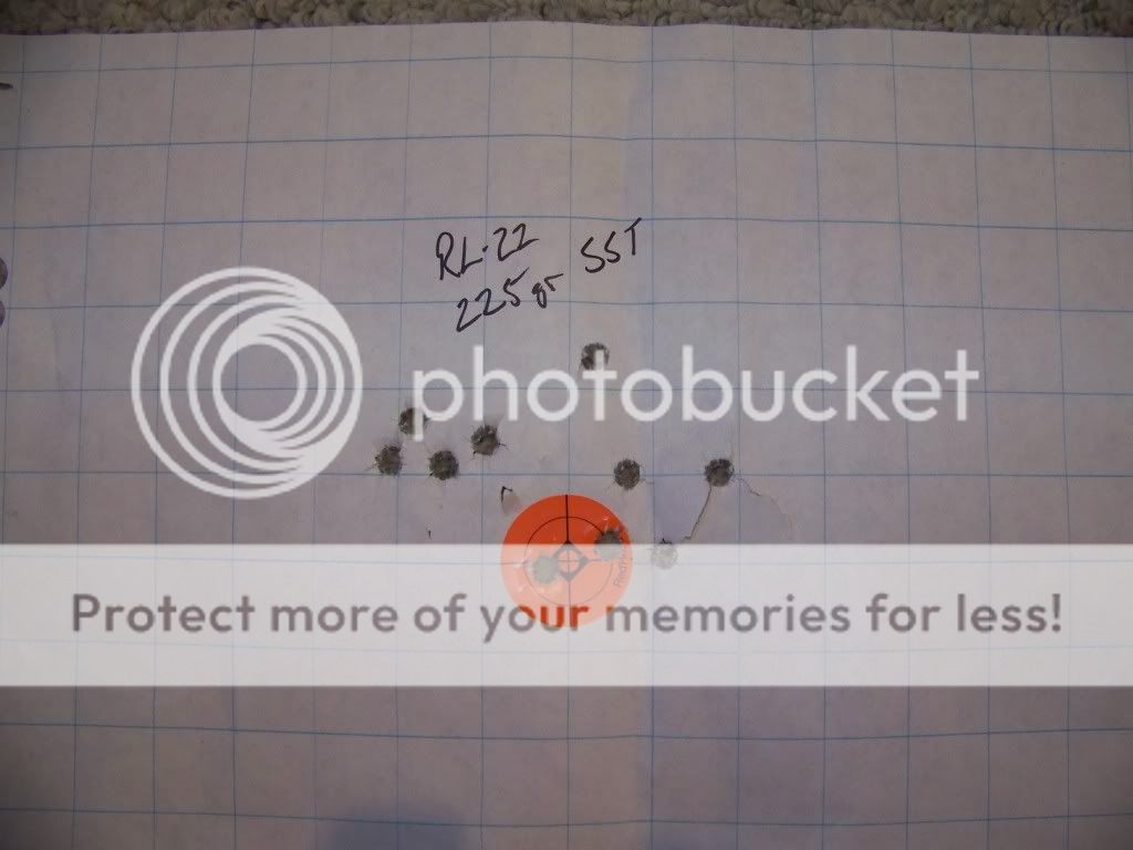

Got out with my new .338 Win Mag yesterday (early 80's Ruger 77). Sighted in with commercial ammo, then shot two strings of 10 rounds each, looking for upper load limits and pressure signs. Both strings used 225gr. SST's, with one using IMR-4831 powder and the other RL-22 powder. I simply fired all 10 at one target, mostly just watching for pressure signs and getting used to the recoil. Range is 100yds. I wasn't trying for groups or anything, but the results were interesting enough that I thought I would ask for opinions on what I see here.
RL-22 target:
Note that the shots are pretty uniformly scattered. I started at 69.0gr and worked up to 75.0gr.

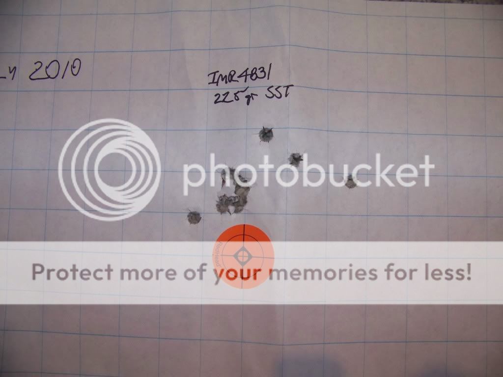

The 4831 target:
The shots are not all scattered in this one. This one started at 69.0gr and worked up to 74.0gr. The first 3 (light) loads threw 3 of the 4 fliers, the bottom left one and the two top right ones. The final (maximum) load threw the far right flier. The other 6 went into that tight cluster that is well under an inch. The loads were incremented in 0.5gr steps for the upper part of the charge weight range.
To me, this indicates a pretty wide node right in the upper portion of my load range and that 4831 is the better choice to pursue for load development. Would that be correct?
Note the rifle is for hunting and is bone stock, not bedded and the barrel is not free floating at all, with a number of contact points along the forearm. Groups did not seem to open up with the heat of firing 5 round strings, which was a nice bonus, considering the lack of tuning that has been done and the forearm contact.
Any thoughts on where to go from here? I am thinking a test with 0.3gr charge increments through the weight range that gave the 6 round cluster with the 4831 and using 3 round groups at 200yds.
