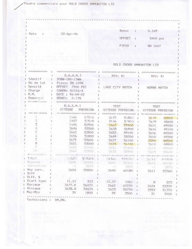

I have had the opportunity/job of pressure testing both SAAMI and NATO ammo.
The limits for 308 and 7.62 are about the same. The difference is not worth noticing. Both flavours run in the 55,000 to 60,000 psi range, with hot lots of both running up to 62,000 average.
The original published specs for NATO were CUP numbers, but the NATO documents referred to the limits as "psi", not "CUP" as is the custom. This caused (es) the confusion.
Here is a test that included both SAAMI (Norma) and some Lake City (NATO).
