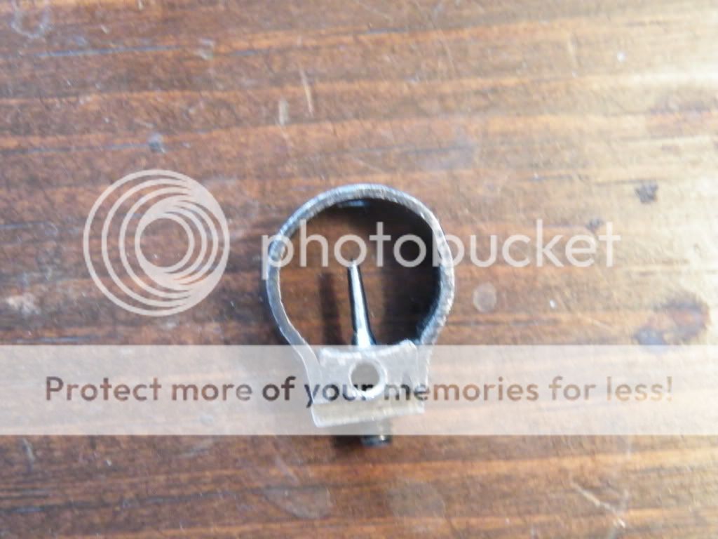

After what Josh and Chumlee have done and not to take away anything from Josh Smiths nice sights, I decided to modify my sight.

It helps to have a Bridgeport Mill and good lathe so as to get that 6x48 hole drilled and tapped precisely. There is not much room there and getting it right the first time dead center is the only way. The original sight punched out easy from the top, then I turned the taper a little enough so the sight would pop up 1/16", loctited the set screw and ready to zero next time at the range.
Not the best camera and pic, but I hope you can see it.

I just tapped the hole for 6-32 and ran another one in perpendicular. Then I turned a long 6-32 set screw into a sight pin. not as nice as the smith sight with the fiber optic but fast enough for an old man.
