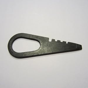

Did you use the mosin tool while reassembleing the bolt?

I used the tool last time i put it together lol. I striped and oiled it and its working good now but who knows what will happen at the range. Not sure why the blot locks in place so I cant open it but its fustrating.
