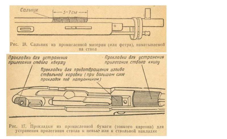

I also ordered the shim kit from Smith Sights. This way I do not Bubba anything on my Mosin. My Mosin is a 1944 in a M38 wartime stock.

The barrel pressure pad and shimming should help a great deal.

The trigger job is about the one thing that will improve accuracy on m38. The band between handguard and stock will not do anything except preventing the handguard from sliding forward after each shot. Barrel band is more effective on 91/30 which has longer and thiner barrels. Carbines have thicker barrels and do not flex as much.
I free floated mine, put a cork piece on the front of stock. Polished up the trigger. Mines a 91/59. Cut to 19", re crowned. Trying to work out a new front sight and a full adjustable rear.
