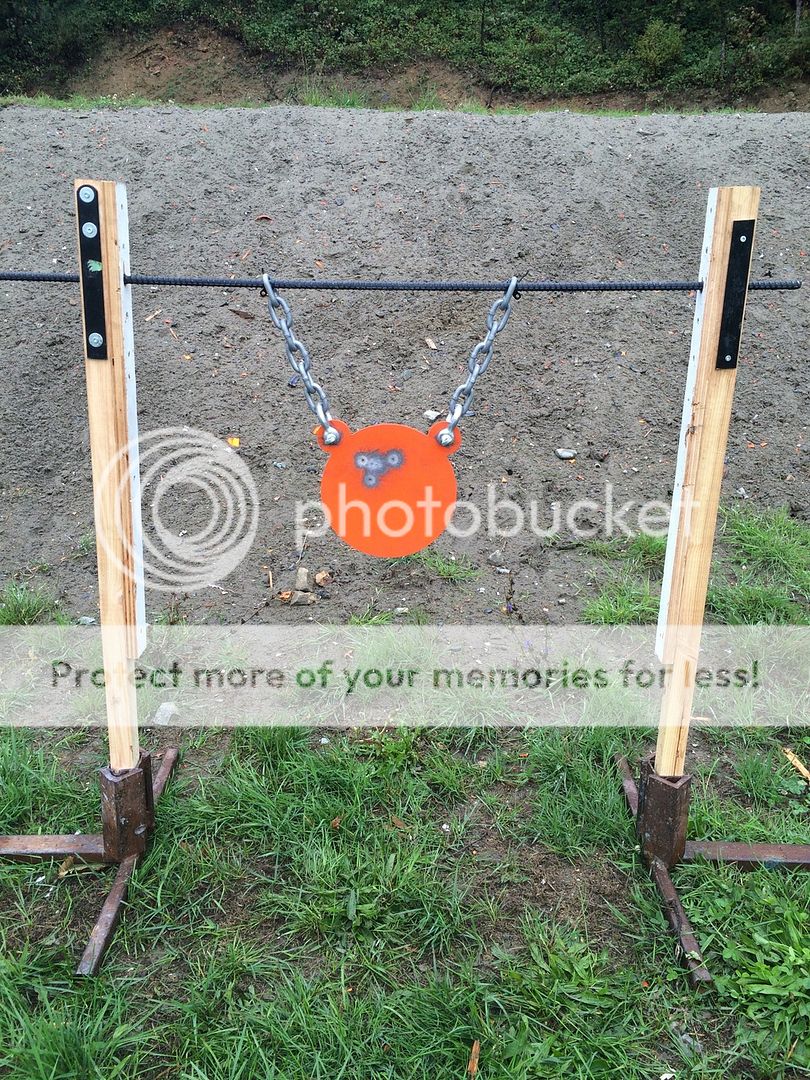

Was out today with a new to me 1942 round receiver Mosin, crisp rifling but bore has some light pitting and is shining up some since I have been shooting it. At 80yrd with a slightly warm barrel I was hitting my steel target 5 out of 5 times, group measured 2"w by 1.5"h with iron sights and new norc surplus. I don't see any reason it shouldn't do the same at 100yrds.
It shoots pretty decently so far, looking forward to stretching out past 100yrds once I get out for some crown land visits.

Here's a couple shots of the steel at 80yds ish, I'm sure I can shrink it with some commercial soft point ammo. Not bad for a wartime rifle with a dark and lightly pitted bore, it will most likely get an optic of some sort mounted. I was shooting off bags for that group but had no problem hitting steel unsupported other than a sling. Group measured 2"X1.5"
