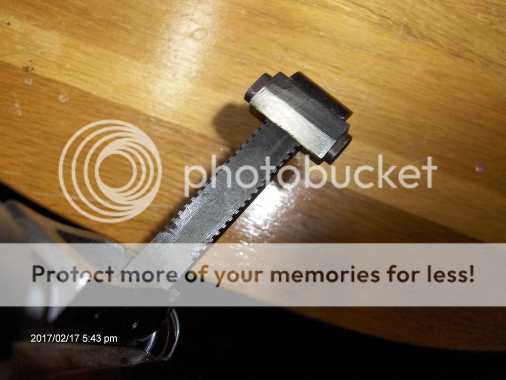

Unless it's a Dragoon:
1931 Tula ex-Dragoon shoots point of aim without bayonet. You can see the area on the bottom of the rear sight adjuster where material was removed. Who did it? I don't know.
