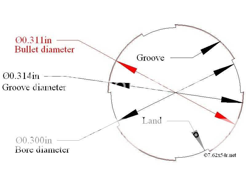

Anyhooo... I slugged the barrel with a lead sinker. I got 0.308 on the land and 0.311 on the groove...
Sounds like I should be using 303 or 7.62 bullets..
Well I found http://7.62x54r.net/ and it answered all my questions...
Looks like I'll try some 0.3105 and 0.310 :)
That sure is a nice diagram SKS - but keep in mind that Mosin bores are known to vary in size from one to another (athough they are all generally thought to be a bit oversized from the official 7.62X54R measurement of .310 that most reloading guides give).
Mine mics at 3.124 (bore groove to groove) - so at least I know I can use .312 Hornady Lee Enfield bullets for reloading. Others however will vary. Even the Lee reloading guide (Modern Reloading 1st Edition) recommends that individual bores be slugged to determine size.
