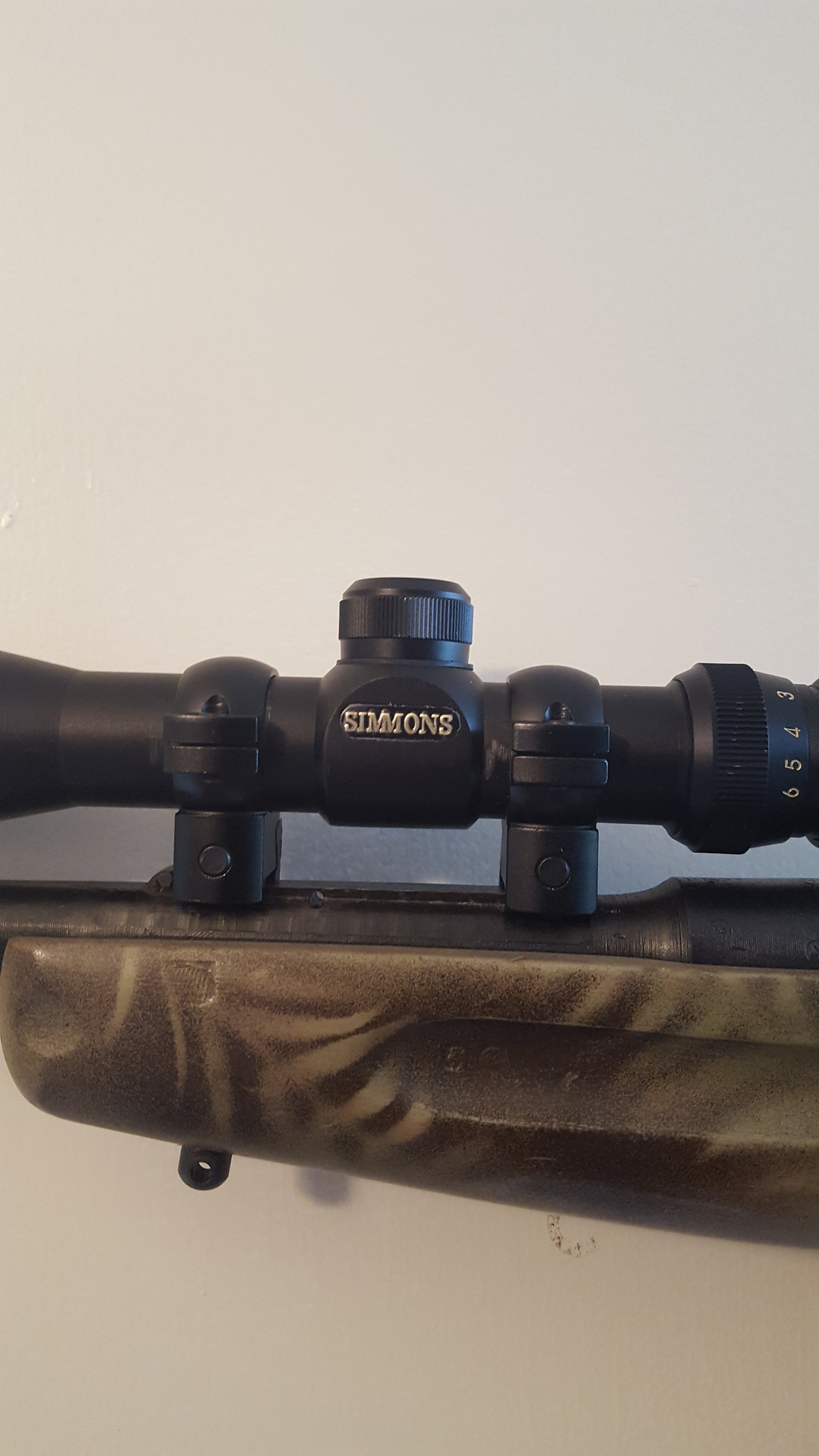

Wondering if anyone has used the badace tactical scout scope mount. They have 2 models. Any feedback would be appreciated. No I'm not interested in brass stacker. Really don't like the look

Save yourself some money, remove the rear sight and the remaining groves in the barrel are the same as a standard 22 mounting, find a STEEL set of 22 rings, spot weld a positive stop at the front of the sight base to prevent creep and you're good to go. If you ever want to restore is back, grind down the stop and reinstall the original sight and voila! The difference in taper is less than a mm.
It's more of a tapered dovetail under the rear sight though.. Starting at 11mm and widening to 13mm if I remember correctly.
I drilled and tapped a couple holes into the top of the rear sight dovetail and drilled and tapped an 11mm weaver scope base and then installed a couple Allen head screws through it into the base. Welding a recoil stop onto the front, ala the Swiss Products K31 scope rail would be a great idea too.
A guy could file out the rear sight base to be perfectly 11mm the whole length, but that would negate the easy possibility of going back to original irons.
Use locktite too...

The Bad ace mounts are no drill & tap, we have both the long eye releif & the rear mount for standard scopes. We also have the bent bolt handle in stock. We have had good results with the ones we have installed.
Nope won't be drilling anything. No permanent modification going t be done
original mosin sniper was drilled in... the original bases are 70 $ or so (1940-1943 manufacturing-can get those on ebay)
do u have a photo?
I didnt tack weld anything. I just used a 3 cross bolt clamp mount.
Use locktite too...
I filed the the dovetail a bit. But it didn't effect mounting the irons back on.
