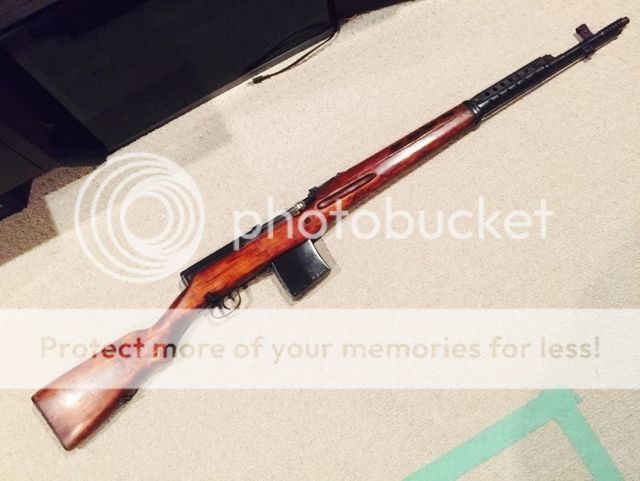

Nice. As long as they have nice bores you can really get those rifles to shoot nice with some minor mods. Here's pics from my last outing with both an SVT40 with iron sights and a Mosin with a cheap AIM scope and a $20 mount. Since all threads are better with pics, here they are.
The SVT40 looks stock accept the sight is all the way moved over to the right to get it to shoot on target.
