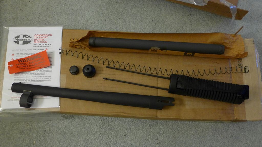

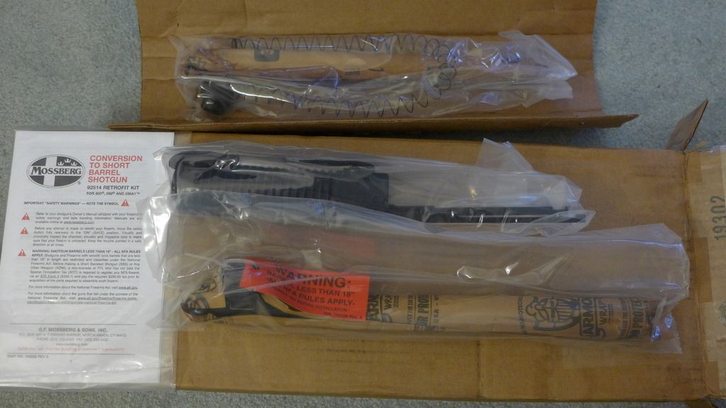

Just got my 14" Mossberg factory barrel kit, it was unusual as there were 3 pieces of sealed cardboard containers with nothing inside... hoping everything that's supposed to be there, is actually there. It appears that everything's there. Here's what's listed on the sponsor's site that I purchased from:
th
Factory Mossberg complete 14" Short Barrel conversion kit for 500/590 series shotguns.
Kit Includes:
14" Barrel
Tube Nut 500A/835
M590/835 Mag Cap, Parkerized
Magtube M514, Parkerized
Magazine Spring Retainer 590/835, Parkerized
Spring, Magazine 835
Forearm, M514
Barrel Assembly 514 Bead Sights Heavy, Parkerized
Action Slide Assembly 500/514, Parkerized
Build will be added later. Just posting an unboxing in case there is any questions to what's actually in the kit. Prices range from $290 - $319 for this kit, I bought it at SFRC for $245 with their Thanksgiving Sale code :) .
Those 3 pieces of cardboard are just extra sturdy packing pieces to keep things from moving around- totally normal. Mine showed up the exact same way.
