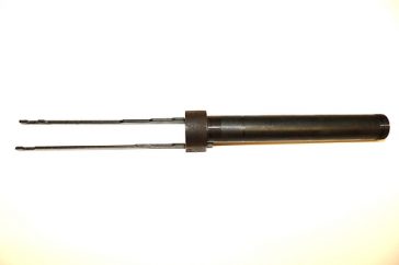

Keep in mind that there are two styles of forearms for Mossberg shotguns. The old style, which uses a tube that the foreend attaches to, and the newer style which has the action bars attached directly to the foreend.
Old style:
New style:
