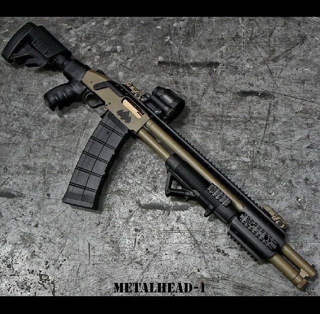

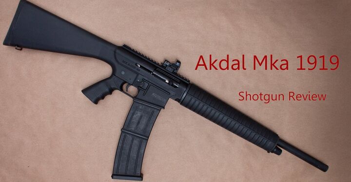

DO NOT PORT THE BARREL.
A ported barrel will put you into "Open Class". That's where you will compete with mag-fed shotguns with optics.
Like this one;
Or this one;
