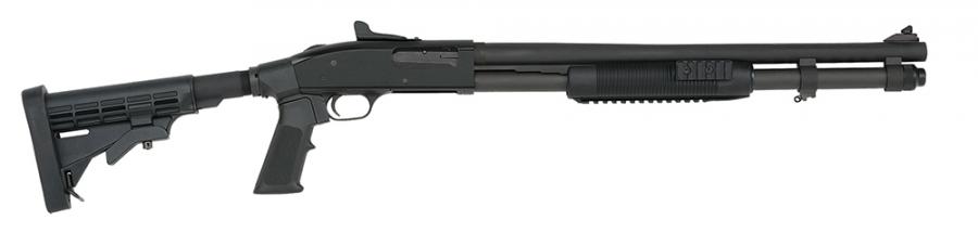

I have been waiting for a month and a half at Irunguns to ship me this super cool shotgun with a Mesa Tactical stock adapter set that fits any AR15 stock/grips. I install it, what do I notice? I can't aim down the sight, stock is waayy too high :(

I found this picture on Google, it seems it would be perfect, but what is it?!??! Does anyone know? It's exactly what I would want, but lower. And considering it's a LEO it's probably quality.. Any help would be appreciated!!
I think the one in that picture is the Mossberg FLEX stock adapter, which won't work on a regular 500/590. The LEO adapter is a little high for a bead sight, depending on your cheek height of course.
Something like the FAB Defense grip adapter should be a pretty much drop in replacement for the LEO adapter you have, you can probably sell the LEO and the Hogue grip and be a few bucks ahead. All the other items FAB makes for the 500 say they fit the 590, but it doesn't say so with this grip; So the FAB grip may require a bit of fitting to go onto a 590, although it may just be a drop in fit. I think it's the 590a1 that has the thicker receiver.

That piece is a factory adapter and it's a plastic POS. I bought that model years back and when I changed the grip the screw stripped the threading on the adapter.
After that I went to a Mesa adapter.
The comb is higher with the Mesa adapter than a regular stock, but a tight cheek weld and ghost ring sights helps mitigate.
There’s nothing ####ty about the Mesa product, you just didn’t do your reasearch before you bought it. A ton of people here have them, all you had to do was ask how high they sit and you would’ve saved yourself some grief. Be glad you didn’t buy the high rail stock kit.
It’s a tactical stock set, which unlike a traditional field stock is usually meant to be used with something other than a bead sight. Sorry to be the I told you so guy but that’s the reality of that style of stock, ghostrings will likely be the lowest sights you can run with that set up. I have the LEO on an 870 clone and it’s the same but I knew this prior to buying.
If someone in the future is browsing Canadiangunnutz with this same issue, here is what I did to solve my problem. They sell a spacer for the Mossberg 500 series that fits on the A1 and 590 aswell.
