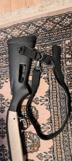

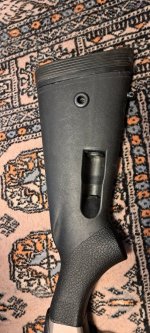

I've used a GG&G magtube mounted front sling attachment, and a Grovetech quick disconnect cup, threaded and epoxied into the right (outside) of the stock.
For a sling, I like to keep it simple and recommend Vickers slings.
The result, when slung, gives the front pump hand a natural hand stop, keeping digits well safe behind the muzzle when working the action hard or under stress.

An 870 Wingmaster of mine (14" Dlask):
