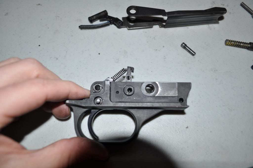

Remove the two retaining pins with a punch and non-marring hammer.
The trigger assembly falls out. At this point, be careful tipping it on one side or the other. Some pins fall out very easily.
If the hammer is cocked, place your hand over it providing resistance and pull the trigger. If the hammer spring assembly falls out at this point, that is fine, set them aside.
Gently remove the main pivot pin retaining the lifter. The lifter and attached parts will easily slide off. Keep these together.
If the hammer spring assembly did not fall out, here it is. Tilt the trigger assembly forward and down to get it to fall out. Technically, this isn't required, but these parts are almost guaranteed to fall out anyways.
Using a jewelers flat screwdriver, carefully pry off the retaining ring and remove the pin form the trigger spring assembly. The retaining washer is a thin C shaped washer (bottom left of first picture) that needs to be stretched a bit to be removed. Do not pull it over the head of the pin.
At this point, the trigger spring and one piece of the trigger assembly should freely fall out.
Remove one coil from the trigger spring using sidecutters.
Carefully reposition the trigger spring and sear into the trigger assembly. Replace the pin and retaining ring.
Replace the hammer spring assembly into its hole. I would not cut the hammer spring as it can cause light strikes, therefore reducing reliability.
Replace the hammer and pivot pin
OPTIONAL
At this point, before reattaching the lifter, you may wish to sand down the edges on the lifter. Mossberg designs their lifters in such a way that they cause maximum cutting damage to the thumb. This part isn’t rocket science, use a fine sand paper and fine jewelers file to remove the sharp edges. You can see below that I also removed the sharp edges from the receiver and trimmed back some of the fore end.
At this point, reattach the lifter assembly to the trigger assembly.
Insert the trigger assembly back into the receiver and use a non-marring hammer to replace the retaining pins. Function test the trigger.
Result should be a clean 2.5-3.0# trigger pull.
