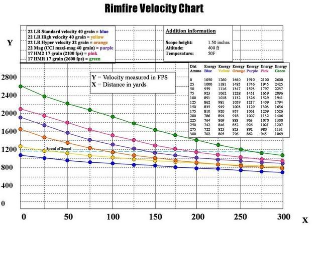

Wind drift goes wonky right around the speed of sound. If you run the numbers, you'll see that just barely subsonic will probably give you less wind drift (and more consistent drift) than supersonic, and the supersonic stuff will likely spread out a bit as it goes transonic.

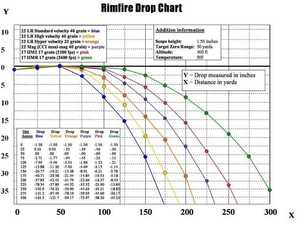

High velocity (or perhaps hyper velocity) ammo may not be a savior at long distances such as 200 or 300 yards because it will have less "drop." It is necessary to keep in mind that even HV ammo has considerable drop at those distances. The ballistics chart shown below indicates that HV ammo has as much or more drop as SV ammo only 25 yards further out. In other words HV ammo drops more at 125 and 175 yards than SV ammo drops at 100 and 150 yards. HV ammo just doesn't have the legs to do much better than SV ammo in terms of drop or velocity (see chart below) as distances increase.
These charts are from the sticky in this forum, found above in Rimfire Ballistic chart https://www.canadiangunnutz.com/forum/showthread.php/63954-Rimfire-Ballistic-charts
