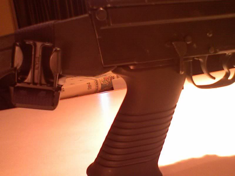

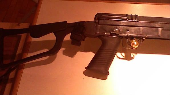

Mounted the Tapco SAW pistol grip this weekend.
suprathepeg
EE Expired
117   0   0
And it is perfect. As with everything I touch I modified it a bit to mount a bit further back over the stock location. It sits nice and tight with a nice trigger feel now. I actually like it more then the FAB PG because its a bit bigger all around and fits my medium-large hands better. One could mount it closer by removing the PG retaining plate but I didin't want to remove the plate and I wanted to mount the PG a bit further away from trigger. It sits about 3/8" further back then stock.
Did some gun figher drills and fun snap shooting this weekend with it and I'm very happy with the setup. IMHO better then the FAB grip and deffinately better then the stock grip. Plus it kinda has a PE90 look to it :p .

I made 2 small slits in the grip to fit over the the collar. The slits are what allows the collar to hold the PG in place. I used a FAB PG length bolt. It would seem that the FAB should be more comfortable but unless you have small hands I think you will find the SAW one better.
