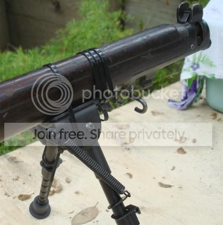

Mounting a Bipod on a full military No4 Enfield
Get an old bayonet, cut off the spike and modify the mount to accept the bipod, that way no mods to the gun and it comes off easy.

The barrel on a No4 is free floated in the stock. It was designed that way. Be aware that your idea will affect the POI and accuracy of the rifle. For maximum accuracy you want to rest the rifle on the wood stock. Maybe get an F Class bipod with a front rest and lay your No4 on that to shoot?

Note how bipod attaches to bar held in place by front action screw and padded U-channel to prevent variable pressure on stock.
Everything comes comes off with no damage to rifle.

From the knox form to the beginning of the front band, yes. That last inch or so of the barrel is supposed to exert a few pounds (4-7) of upward pressure on the barrel.
