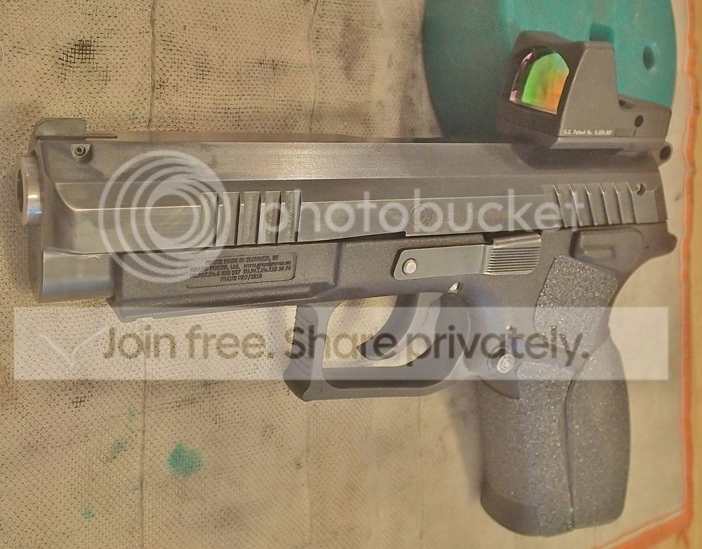

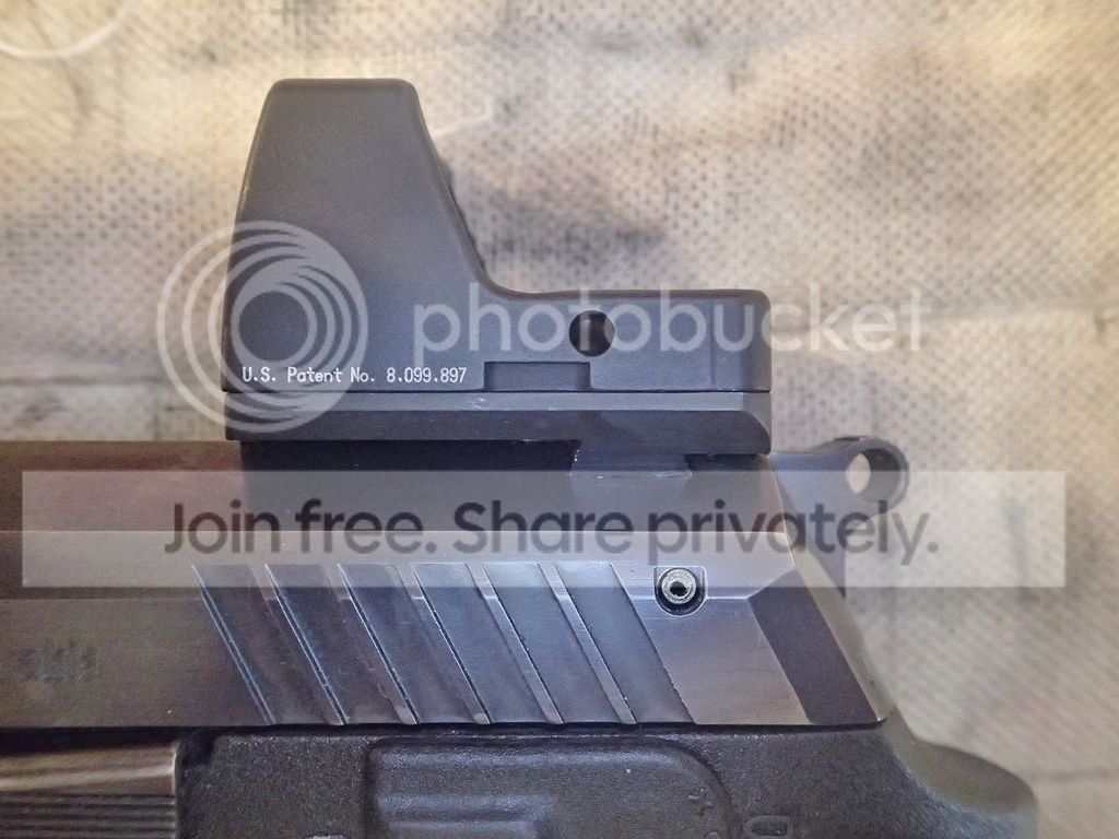

I have a few Grand Power handguns and decided to put an optic on a Mk7 K100. I thought about having the slide milled, but the K100 has an "autosafety" (part #13) that would have to be milled around. I ended up having Chris at Amerigun USA make me an adapter that fits in the standard K100 dovetail. Cost me $140 US, and needed to send me slide down for him to measure it up. The Trijicon RMR is not mounted as low as I would like, but should be fine.
If you are thinking about mounting an optic on top of an X-Calibur, it's technically easier because it does not have the "autosafety". BUT the X-Cal is very finely tuned, so adding more weight to the slide may give you problems. Red Hills Tactical does have an adapter plate that fits in the Elliason sight cut if you want to give it a try. Probably have to run hotter ammo to make it cycle properly.

A small red dot like shown in the rear dovetail? That's OK. The sight is light enough to not be a big issue with the recoil operation. But put a rail and a big heavy red dot or handgun scope directly onto the slide and the whole mess becomes way too heavy for the recoil and cycling to work correctly. Lots of jams will be the result.
That's why all the IPSC and USPSA race guns use a mount that extends down onto the frame which doesn't move. If the sight you want to use requires a pictatinny rail and it's of much of any size and weight at all over what these small red dots weigh then you're in for problems. Instead you need the same mount as the race guns use.

The K100 eats anything (although noticeably more recoil/muzzle flip than the X-Calibur), so putting the RMR on it was fine, and I may use it to play in the USPSA "Carry Optics" division and just general range fun. That RMR is too small for me to pick up reliably though on a draw or when posting up on a target on the move. That's why they run those huge frame mounted C-More red dots on open guns.
