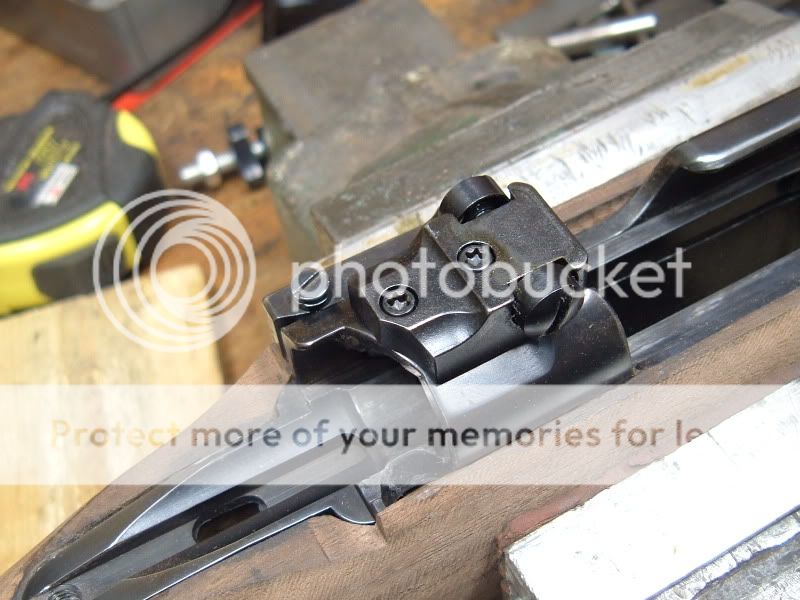

The first is Oberndorf Brazilian 1908 9.3X62. I wanted to keep the hump and so had the rifle d&t'ed for Warne bases. Unfortunately the Warnes were factory defective(drilled off-center). Plan B was using Leupold bases designed for a FN Mauser. The rear base had to be modified to fit over the hump and, because the bridge holes were further back, have a corner milled off. Even with the more rearward positioning, my VX I fits just fine but with no room for forward or rearward adjustment.

That sounds like the answer to me. With the leupold STD. extension ring set the rear ring is a regular one, and the front one is offset. The front ring sits 5/8" farther back. As for the rear ring check out mauser 98's first picture of the 9.3x62, thats the rear base and the ring would be centred on that, on those two big flathead windage screws, the front edge of the base being pretty much up to the edge of the action opening. So that rear ring sits farther ahead with this type of base than with others, say like a two piece weaver base.
