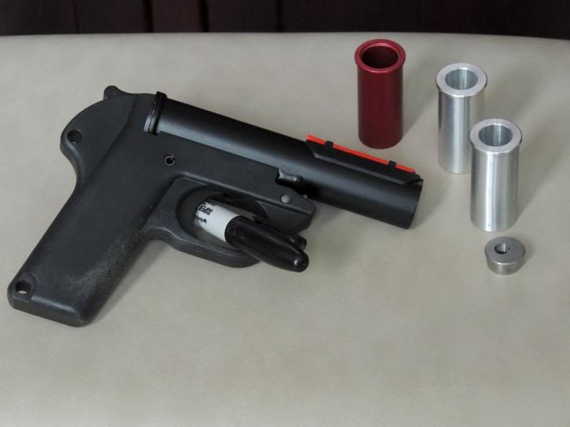

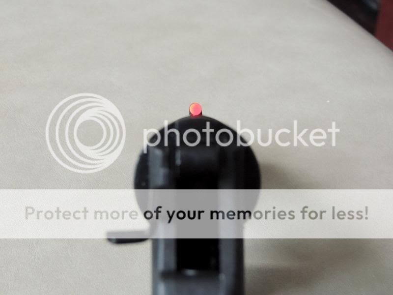

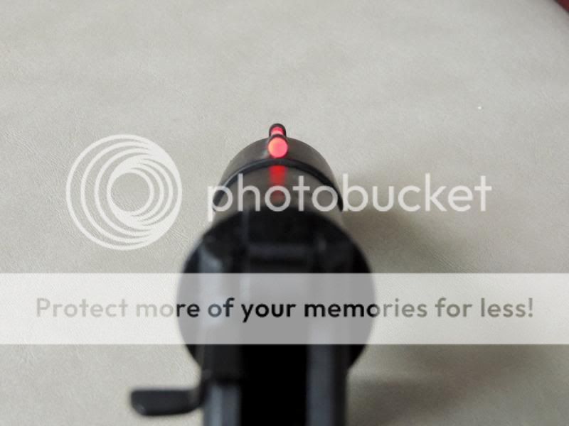

I've launched a lot of pen crack flares as well as signal flares (back in the old days when we didn't have radios for talking to the helicopter pilots). I have seen a few pen flares split their cases on firing so I prefer to fire them from a pistol if the added weight is not a factor.
The red adaptor is a 26.5mm to 12 gauge from Frontier.
The 2 aluminum adaptors are 26.5mm to 15mm TruFlare CF (flare and crack flare) that I received from a board member.
