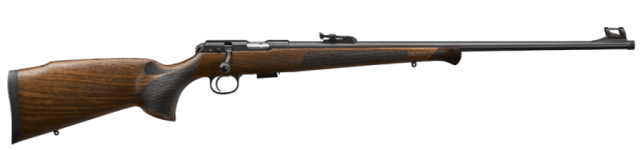

As a new member, new license holder and soon to be new owner of a lovely CZ 457 Premium after a deal done with a member here I wondered if anyone has any advice on mounting a scope to this rifle?
As you can see the CZ 457 Premium has iron sights mounted. The rear is removable but I do not want to remove it because as someone new to the sport I want to hone my skills on iron sights as well as using a scope. So my question is does anyone know which rings I would need that would allow me to mount the Athlon Talon 4-16x40 to the rifle while also maintaining the iron sights?
I am considering adding a picatinny rail to the dovetail which would allow me to easily pul the scope so that I can practise with the iron sights and then to easily reinstall without requiring a new zero when I then want to use the scope. I can see myself wanting to play with both options for the first few months at least so having the flexibility for this I think would be fantastic. Yes this adds weight and I would not do this if my intention was to hunt which, right now, it is not. When I get to that stage I would likely be moving up to a centre fire platform anyways and would have an entirely new setup built specifically for that purpose.
Is anyone able to help me figure out what the best mounting options would be for this setup so that I don't end up spending a small fortune on mounting rings for the one rifle that I currently own?
Thanks in advance everyone!
Dan

As long as the scope clears the rear sight, you don’t have to worry about the front site being in the way. The front side post will disappear and won’t be seen in the optic, especially at the higher magnification. Looking at the photo of the CZ and the athlon it appears the Avalon has a 44 mm front objective bell (I had to convert the measurement. I have never seen that in inches before.) medium rings and a rail should clear it.
