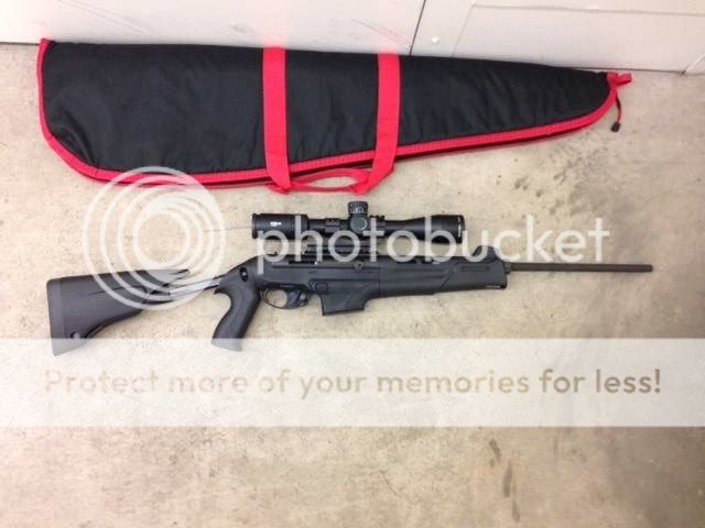

My used $1200 MR1 came with a Burris 3-9 already mounted and the rear sight detached with the screws missing. Since I wasnt a fan of the iron sight setup on the gun to begin with, and my intended role for the gun was purely as a semi auto varmint gun. I did the unspeakable and CUT the front sight completely off! To solve the eye relief issue, rather than buying the ATR rail (which I didnt know about at the time), I simply bolted the original rail on backwards... That gave me the ability to mount the scope at the perfect eye relief. Because the front sight was removed, I was also able to the mount the optic super low, offering bolt gun height over bore characteristics. It turned out pretty slick IMO

These pics all have the Burris scope that came with the rifle mounted to it. The 4-12 Nikon sits waaaaaaaaay lower... like maybe 1/8" clearance between the OBJ lens and the forend.
Slick, how's the cheekweld Murray?
Cant remember how it was with the pictured setup. But with the low mounted Nikon it is perfect. In fact I'd go so far as to say its the most comfortable shooting setup I've witnessed yet in my collection and other guns I've shot.
I removed the rear sight and turned the picatiny rail around to gain more rearward space to mount the rings. I put a Zeiss Conquest 3-9×40 on tactical rings. These scopes have a full 4" of eye relief. I found that my fixed comfortech stock was just too long for me so I removed the factory butt pad and put a thin plastic one in it's place. Of course it required some goofing around but I didn't want to alter the stock in any way so I got creative. The 1" that I gained made a world of difference.
