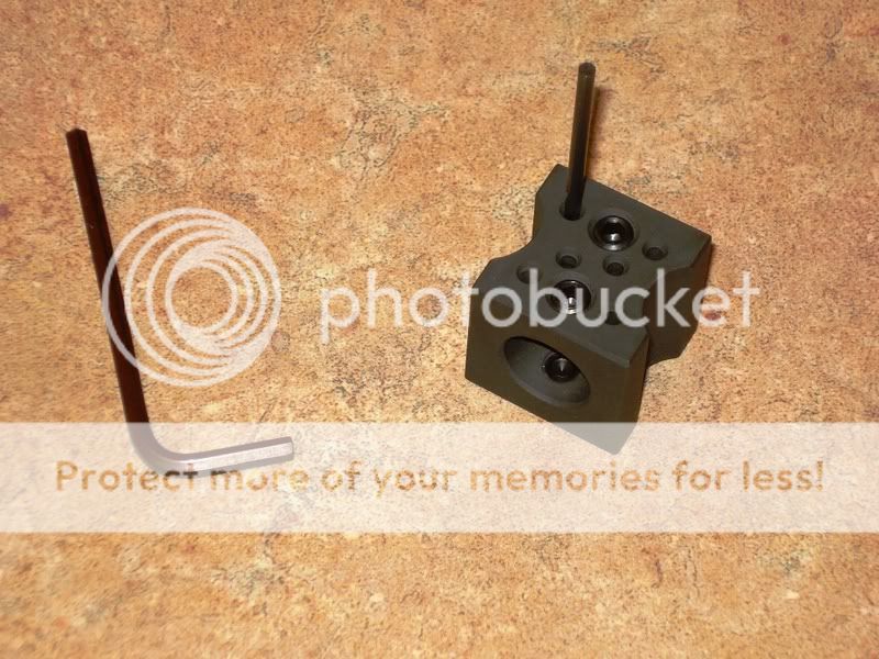

We do make an installation jig and a brake for the SKS, but I don't think S&J Hardware carries them yet. Basically the installation tool makes two radius cuts in barrel (like the ones that the pins in your front sight go through) and then the brake slides on and two hardened dowel pins are tapped into the holes in the brake collar to secure it. It is a little more work than a simple setscrew part, but it is a solid installation and guaranteed not to come off. Plus, the KA-1230 brake unit works perfectly on that application since it is made specifically for the 7.62x39 round. The product details page is here:
http://kingarmory.com/My_Homepage_Files/Page24.html
Here's the tool

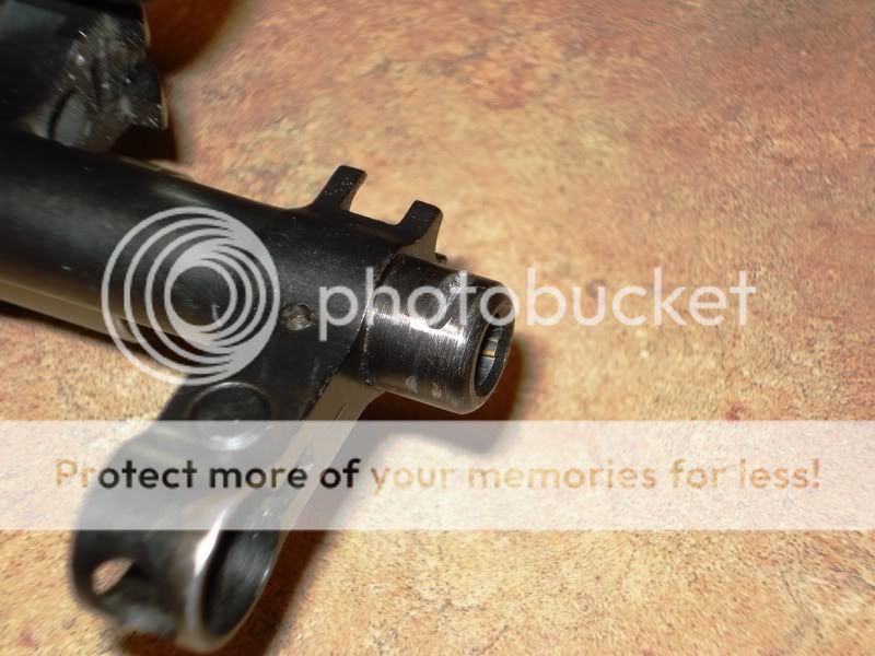

Here's the radius cuts it leaves

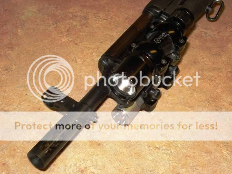

And here is the KA-1230 installed on it
